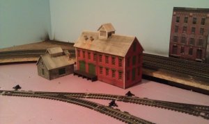

bklynman-- Never too late to comment. Although I wanted to get making the "hump" yard right away, we (the boss and me) decided to wait until we moved in, which is still a few weeks out. I bought all the switches and track already, though. Assembled some low profile switch stands which operate.
A friend of mine lived near one (real one) of these in St. Paul/Cottage grove and talked about it's operation. Did you watch the youtube video? I thought those cars moved kind of fast, too, but my slopes are intended to be more gradual; and I will mock it up and try it out before nailing it down. Putting some grass in between the tracks is definitely doable and will be easier for me to perform than the air gust.
I suspect some of my cars will work on it and some won't, or I may have to rework some trucks and couplers to get it fully operational.

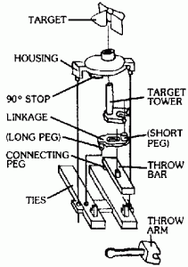

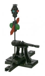

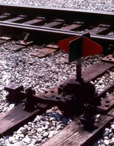

Are those the Caboose Industries hand throws that look like real stands? Or are they operated *by* the turnout instead of the other way around?
Erik,
I bought Rix short switchstands to go in my hump yard, and they move (operate) automatically with the points:
I installed 5 of these so far and they have to be lined up perfectly but work great and look nice.
I also purchased some of High Level Caboose Industries, but I think they will only work manual; correct me if I am wrong.
lasm
The HO layout of the New York Society of Model Engineers, in Carlstadt, NJ has an operating hump yard. If you check their website, they might have some video's too. Last time I was there in person, it was about 4 tracks wide.
Erik,
lasm
That's correct -- essentially they're a more realistic ground throw. I've been debating whether I want to use them at least in some places, but I haven't made up my mind.
Erik, I am using mine in a couple spots where I will have easy access and on spurs that I don't use that often. They look really cool and have a little gear mechanism so the lanterns turn when you move the lever.
The instructions are terrible, but I got a better idea of how to put them together from their web site. Still, they are lame on their schematics; wheras the Rix product gave an excellent explanation of assembly.
