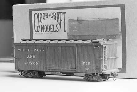

I originally built this mythical railroad boxcar (East Bottom Top) and was able to get WP&Y decals back in the dat, some 35 years ago. It's a Gloorcraft wooden kit and a delightful little project. Wood is fun to work with. A little damage, later needs to be replaced and the sill at the far end has disappeared. No worries, easy enough to make replacements. I used this one as a guide to create print files for a couple of my own.

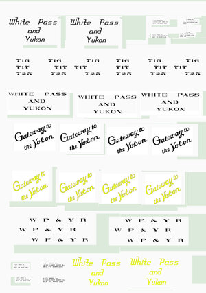

WP&Y used a lot of Colorado and Southern Boxcars, which I have also recreated. I made a file to attempt to print some boxcar lettering. I did find a number of photos showing these in yellow lettering, which is doable as opposed to white in home printed decals. I also found some photos of the C&S style boxcars which appear to be (maybe) in OD. An individual boxcar often has gone through several paint jobs and markings. The color in old photos is so bad as to not be able to determine the exact color.
Decal experiments depending on obtaining some new printer cartridges. The timing was impeccable! This was one of the early sheets I was working up.

The local Office Max had the appropriate cartridge for my small PIXMA printer and I printed off two decal sheets. ZO... We shall see how well they work. No way of telling whether or not WP&Y always used yellow lettering (or black) or mostly white. The available color photos tend to show a lot of yellow lettering. Certainly black and yellow does have prototypical evidence. Yellow lettering in typical panchromatic photography with a yellow (typical) filter would look quite white. Photoshop has proven quite useful for creating or re creating such graphics. That "Whitespeed" and RR Roman are available as fonts, though the WP tank car numbering seems to be more like USN Stencil.
Geez...I built at least one of those Gloor Craft kits myself (standard gauge tho). Used Android cement to put it together. It had what was basically a piece of scribed wood for doors...and I almost want to say "Z" angle wood for top slides? Ala "Campbell Scale Models," as used with so many of their structure kits.

Decals not adhering as well as I would like. I’m sure I’ll get it worked out, eventually ….
