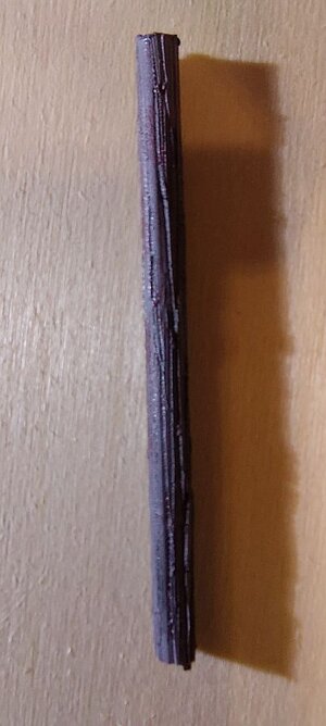

I really appreciate all the suggestion you guys have submitted. I tried several, but none seemed to work but then, when I asked myself "what would a
really lazy guy do?", the answer came to me. I purchased a pack of Plastruct 4 mm plastic tubes, cut them into N scale lengths, grooved them along their lengths with a fine tooth hacksaw blade painted them grey, applied a black wash to highlight the grooves, and dry brushed some brown streaks which seem to be a feature of the Oregon conifers.
Here's the result. It's not perfect but it will do for the 100 or so more I have to make. Thanks again, everyone.
