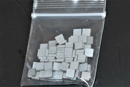

Tungsten chips. You're welcome.

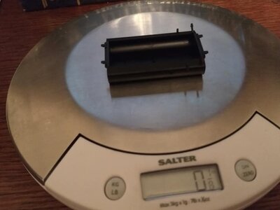

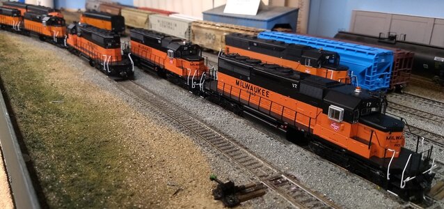

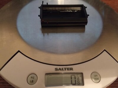

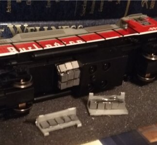

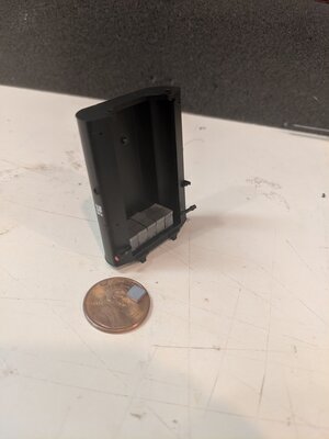

Walthers and ScaleTrains locos are much the same, but the ol' Athearn engineers of today aren't as smart, apparently. My Athearn RTR SD40-2's do not compare to ScaleTrains in terms of pulling power, and as I don't always want to drag out 4 locos to get the job done I sought a way to fix this. Fortunately, a friend of mine figured it out before I did and turned me on to tungsten weights for pinewood derby cars. The results are below
North Metro club has a pretty severe helix to get between its main staging and the layout surface. The club also has a nicely performing Piggyback train, which two of my ST's were able to get up that helix without a problem. My two RTR's, however, would not. So, I remedied this by stuffing both of their fuel tanks with tungsten chips I bought off eBay. Each ounce is approximately $4, but well worth it to improve performance. I have since done this upgrade to ALL of my Athearn RTR SD39's, SD40's, SD40-2's and Genesis GP9's with no regrets. So far I haven't found the need to modify my SD45's or SD45T-2, so Athearn must have gotten those right.
I get these chips from one eBay seller named TXalchemist. I have also applied them to other diesels, like my Bowser AS-616 with good results. Anywhere you have open space you can fit these little weights easily. No more trying to fit big wheel weights into a loco hood or boiler. I have also used these chips to improve pilot and pony truck performance on my GS-4's, my Little Joe and my BLI 2-8-2.

VERY interesting DakotaLove39,
Could you describe in a little more detail how you prepare and glue in that Tungsten chips / powder.
Or perhaps I should have asked if you have ever used the powdered form?,...since it appears you prefer the chips??
