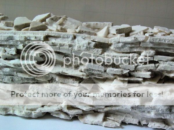

I poured layers of plaster which I broke and stacked to make a 'shale' rock face. Made a latex mold of that. It came out pretty good I think.

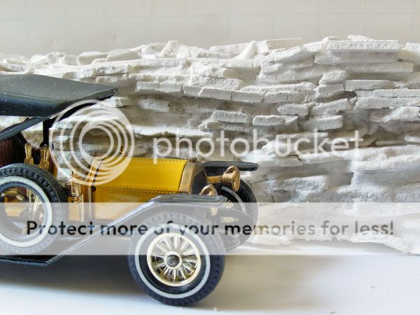

Close-up of the 'plug'. I sprinkled baking soda into the crevices and used a thin super-glue to fit it. Larger spaces were filled with some Sculpey

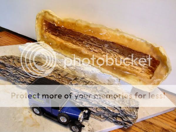

Here's the mold on top of the plug with a painted casting. The car is 1:50 for reference
Close-up of a 1:48 car alongside the plug

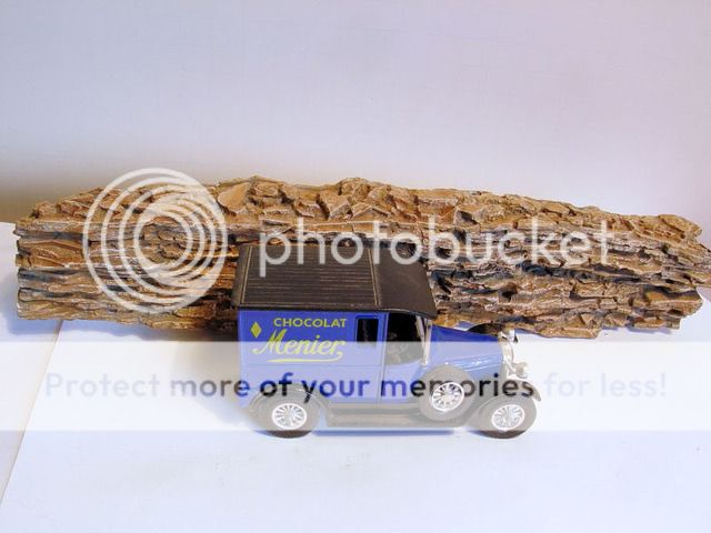

another of a 1:50 car alongside the casting

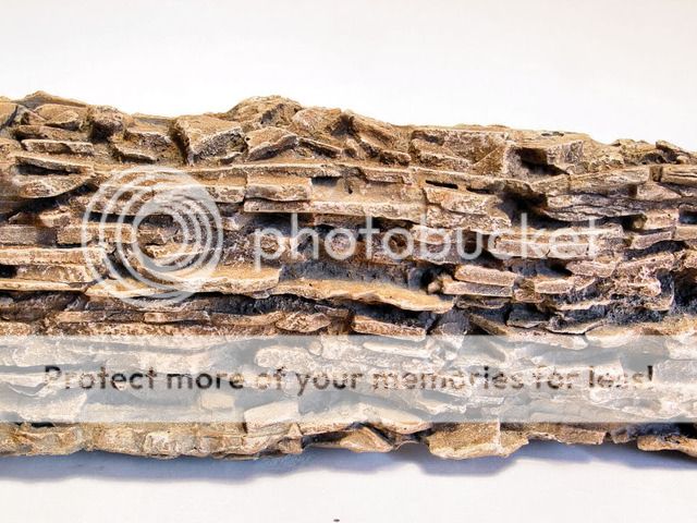

.. and a close-up of the casting. Not satisfied with the coloring but the layered rock effect I am pretty happy with.
