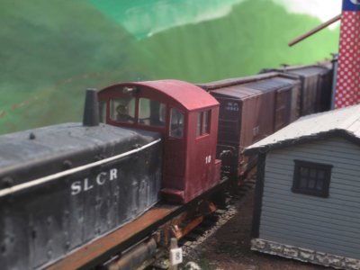

I have one of these Walthers SW-1, it was painted BN. I bought it new/old stock, never assembled in the factory package (on ebay a couple years ago). Is a great runner, I repainted it for my logging railroad. This loco does very slow speeds dependably well.
here is a pic of mine:
