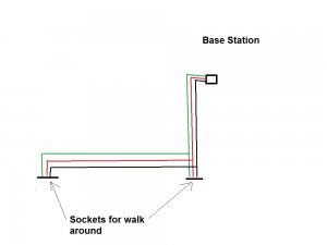

Thanks for the review and video Dave. As I mentioned in another thread, I am looking to replace my current walk-around memory throttle that is second-hand. Chet had mentioned some features that you showed in your video that may have made the sale for me. The "large" stereo jack and the slim uncluttered throttle are the two main features that I like. I have a question regarding the remote plug-ins. Do they each need to be wired separately or can I "piggyback" from one to the next? My furthest remote would be about 50' from my control panel so it looks like I can use the reels of 18 gauge wire that I already have on hand. As Chet said, "There aren't many of us left still running DC only", so it is good to see products still being made for us.

You can feed one plug directly to the next one further down your layout. No problem.

Also, suitcase connectors could be used to simply wire one jack to another one behind the layout. All the wires do not have to go all the way back to the base station.
There are 3 wires that go into each socket, since I have 2 cabs there are two sets of three wires.
I've had one of GML's DC hand held throttle just like yours for close to 20 years. I've never had one problem with it. A nice feature I didn't see you mention, is you can unplug the hand held throttle and your train will continue on until you plug the hand unit back in and give the train another command. There is also a 3 position "Pulse" switch which might improve the slow speed of your locomotives. I converted to DCC operation about 15 years ago, so my GML Unit has been relegated to running my Turntable, which it does admirably. This is indeed an excellent product. At the time I was converting to DCC, I put in some remote locations for plugging my DCC hand held throttle into and at that time. I thought I would still like to operate some DC locos at that time; so, also installed remote connectors for my GML handheld throttle at the same time, however, DCC has taken over train operations on my layout. The wiring for those remote connectors is exactly like what you have shown in Post #6.
