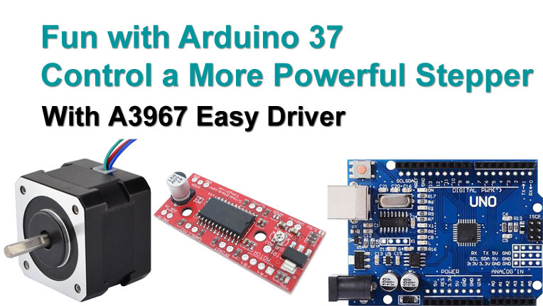

Fun with Arduino 37 Control a NEMA 17 Stepper Motor with Easy Driver
Several driver circuits are available to control a more powerful stepper motor like a NEMA 17. In this video the EasyDriver is used, but the software is applicable to any driver with Enable, Direction and Step inputs.
Link to Fun with Arduino 37 Control a NEMA 17 Stepper Motor with Easy Driver

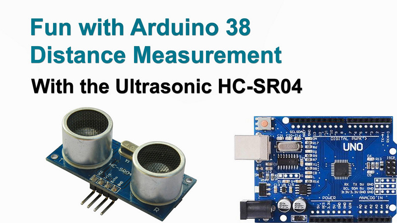

Fun with Arduino 38 - Ultrasonic Distance Measurement with HC-SR04
The HC-SR04 is a sensor that has a little loudspeaker and a little microphone via which the distance to an object can be measured. It's ultrasonic, humans can not hear it.
Don't expect super high accuracy of this less than $1,- costing device, yet I was pleasantly surprised to see that measurements with an accuracy of a couple of mm are very well possible.
Link to Fun with Arduino 38 - Ultrasonic Distance Measurement HC-SR04

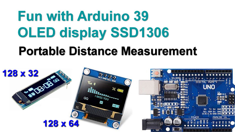

Fun with Arduino 39 - OLED display SSD1306
We're going to add an OLED display to the ultrasonic distance measurement of the previous video. Together with a battery it now becomes a fully handheld portable device. This is just for fun, the actual purpose is to introduce the OLED display ... once we have that up and running there's a whole lot of fun and useful applications where they can be applied.
Link to Fun with Arduino 39 - OLED dDisplay SSD1306

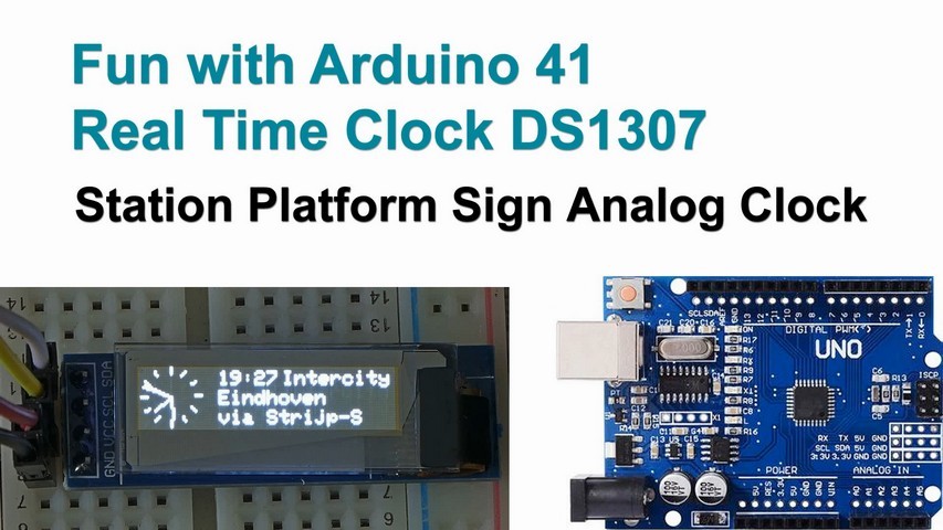

Fun with Arduino 41 Real Time Clock DS1307
The station platform clock of the previous video runs, but it shows a random time. We can add a Real Time Clock module to have it show the current time. Several versions of Real Time Clock modules are available. This video is about the DS1307 RTC, which can be had for under $1,-.
Link to Fun with Arduino 41 Real Time Clock DS1307
