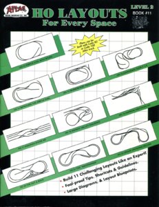

I am working with the Atlas HO-15 "Minimum - size twice around" track plan. I have it up and running. The wiring described in the plan book #11 was helpful. Now look at this option : I came off the bottom or top spur and continued to make an up and over ovel that comes back into the inside spur. The main layout is run be DC power, (1) transformer (for track power and switches). There is another transformer for the lights. All the plastic insulators are placed correctly on the main plan. Now with the extension of the up and over ovel I added, I am having problems with the placement of the new plastic insulators and running off the main transformer. I does not work. Do I need a separate transformer for this ovel? Where to place the insulators? Any help is needed. I am not running DCC.
Is it the top one left one?

This is what I am looking for. Need help in wiring in the Atlas #220 controller and placement of the insulated rail joiners. Any ideas, diagrams or pictures would be helpful.
Looking at this plan: I am coming off the top track (using it as the mainline), coming around putting in (3) truss bridges then coming around and go under the truss bridge and connecting back to the middle line. Does that make any since?
Atlas used to sell a wiring book that explained the use of their electrical components in detail. It was generally sold along with the track plan books.
Because you still didn't say if the diagram I posted is what you meant, I am still guessing but the 220 controller the X and Y (yellow and green) go to the reversing section. The C(red - not to be confused with the "new" red track) and top right output (black) go to all the main. As below. The four purple dots are where insulated joiners would have to be for this expansion. This is in addition to all the other normal insulated joiners shown in the plan. I drew this track with Atlas Right Track software (RTS).
