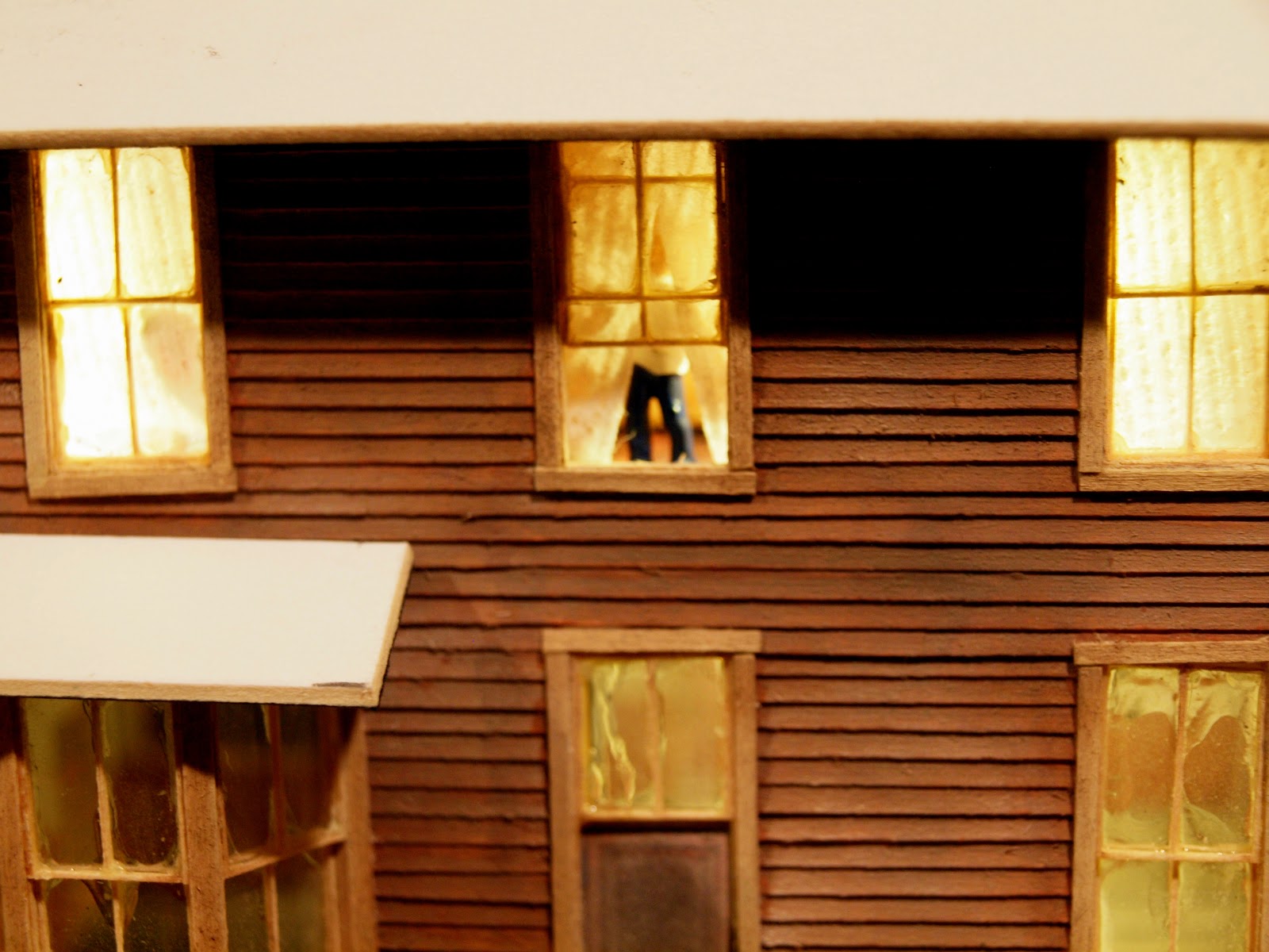

The wallpaper has been hung, the carpet's installed, and the lights are permanently wired up. Looks like the railway agent and his family have moved in - somebody's peeking out of an upstairs window.
As you can see, I used warm yellow LED's throughout the structure, upstairs, downstairs, and in the freight area. Five bulbs in total, each with its own resistor, soldered and heat-shrinked, held in place with hot glue in case I ever need to replace one. The upstairs ceiling lifts out to give me access to the first floor bulbs.
The upstairs windows are covered with curtains made from toilet paper (clean, I think). They're just transparent enough to allow some colors and shadows to be visible. The one window with the open curtain, the one shown above, allows just enough to be seen to create the illusion of a fully detailed upstairs.

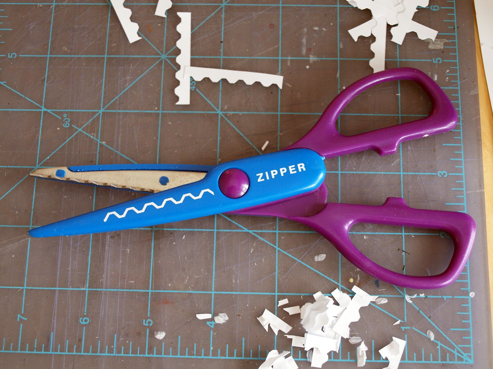

Like many people, my New Year's Eve celebration involved lots of small bits of paper. Thanks to the bad cold that I've been fighting, which triggered the occasional cough or sneeze, my bits of paper would occasionally fly through the air, like New Year's confetti. A few pieces landed where they were supposed to - on the roof of my depot, where they're intended to look like decorative roof shingles.
I started by cutting a piece of plain white printer paper into 1.37 inch (10 scale feet) strips. Using a special pair of craft scissors, I then cut across those strips, in 1/4-inch intervals, to produce a pile of scalloped strips.
Turning these scalloped strips into roof shingles is a simple matter of gluing (with plain white Elmer's glue) a row of strips across the bottom edge of the roof. A second row of strips is applied, overlapping and slightly offset from the first row. Repeat with a third row, then a fourth, and so on until the roof is covered.

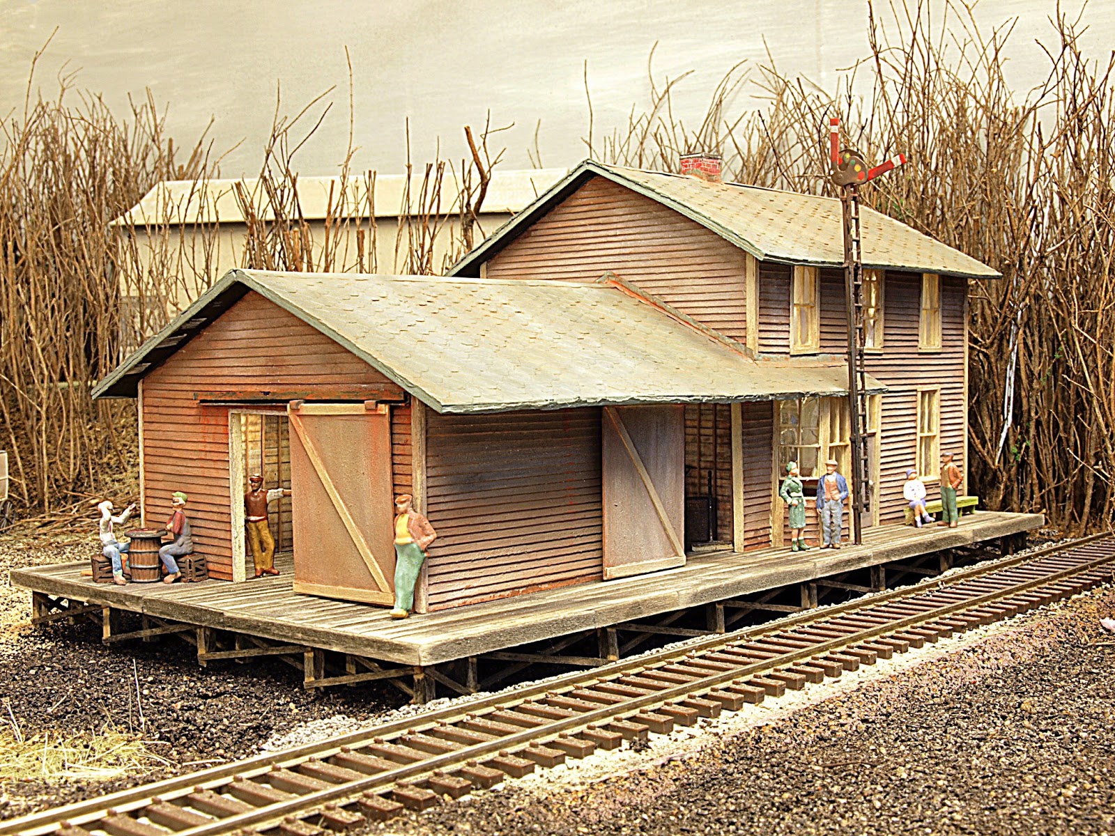

I am officially declaring the depot finished. Today I installed the train order signal (scratchbuilt, of course), which I believe was the final addition.
The train order signal is built from a piece of brass tubing and a commercial styrene ladder. If you've been reading my stuff for a while, you can guess what the arms are made from. Yep, they were cut from that plastic "For Rent" sign. The arms are movable too, so I can position them differently from time to time, just for variety.
Here's how the finished product looks sitting on the layout, all hooked up with the lights turned on.
