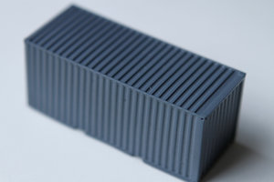

I recently 3D printed some sea contains in HO scale, I was going to paint them in LINFOX colours. Since I do not a have smooth surface in which to place a decal and masking for painting may not come out that good. Is there another way to place logos onto an uneven surface.

I'm wondering if it's an idea to print the yellow LINFOX diamond symbol onto a common stationary store address label, the kind that has a peel off backing. If it wasn't too thick, you could peel the backing off as you are carefully wrapping the symbol around the corrugations.

I think those stickers maybe too thick for that, I was thinking of using Decal's that you can print on an ink jet or laser printer.
My photo is from the back, but it looks like the photo above at the front
You can use decals on ribbed surfaces as long as you use micro set and micro sol.
Micro sol is the one that will soften the decal and allow it to form to the surface.

I encounter that situation with some custom decals on the sides of ribbed hopper cars. I used the Micro Set applied where the decals were to be applied and then the red, Micro Sol on the decal themselves. As the decals started to settle int the channels, I use Walthers' SolvaSet which is a stronger solution than either of the Microscale products.
I let the decal settle and dry over night and the results were great.
Be patient and carefully brush the SolvaSet over the entire decal and lay the container down with the decals facing up to have gravity help settle the decals while they dry.
