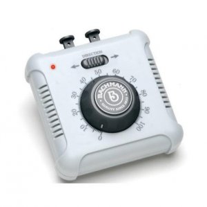

would i be able to use one of the power packs from a Bachmann trainset as a second power pack for 2 train block control?
this power pack is one of the small gray squares with a black knob?
thanks

bachman.jpghere is the picture of the power pack i asked about using as the second power pack thanks
Are you planning to use this as a booster, or as a control unit for an isolated section of track?
Not without blocks, toggles, and separate wiring. By the time you do all that, it will certainly make sense to upgrade to a better quality power pack. Save the one you have for powering accessories.
The answer is Yes, but the forum software won't allow a post that is only three characters. Just connect the Bachmann as one of the cabs.

Mark I've never seen one of those Bachmann units. Is it a stand alone power pack that plugs directly into household outlets or is it a simple add on throttle that connects to the fixed DC output of a power pack?
I had one of these power packs and it easily powered 40 feet of track with 6 turnouts and with only one feeder. It could even push two locomotives around the track.

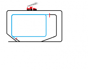

Sorry, H44, to hijack the thread, but I'm a little confused. I am basically planning on doing the same thing, but the thought of the third block doesn't seem to compute in my mind. Take a look at my (bad) drawing of my layout. I have an additional controller that I want to use. I was going to isolate the inner loop (in blue) from the outer loop (in black) by simply putting in isolators where indicated in red. Would this work, or do I need something else to make this feasible?
(ignore the goofy train. It's been along day... I'm getting punchy...)
Traditional DC block control doesn't work like that. Instead, each loop would be broken up into multiple blocks, each of which may be connected (often with a toggle switch) to any of the DC powerpacks. (Folks call the powerpacks "Cabs" in traditional DC block wiring). This allows trains to move from one loop to the other, for two trains to share a loop keeping independent control of each by flipping toggle switches as they move, etc. In theory, any number of Cabs (powerpacks) could be used.

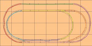

As GenSet said what you have drawn is not considered normal blocks for DC cab control. Normally you would divide the layout into blocks as the diagram below. Each color is one block so there are 9. Then there is one wire to each block that goes to a selector switch that chooses which power pack or (cab) controls that track. The selector can choose any number of cabs so 2, 3, 4 it doesn't matter. Any power pack can control any block.
So what you are thinking of as a 3rd block is actually a third control. There need to be many blocks to work right.

And Iron Horse - Your drawing is WAY better than mine. ;) I guess having the proper software helps, huh? :rolleyes:
Yes. Always the right tools. That is just Atlas Right track version 8. I've gotten so used to the software I can throw a layout together pretty quickly. Then I exported in to Windows Paint to add the colors.

In general the rule is absolute minimum of 2 blocks per running train. That is one for where the train is, and one for where the train is going. The reason I chose 9 for this is that it would allow two trains on each loop. Of course the smaller the block or faster the train the quicker one has to flip switches.
