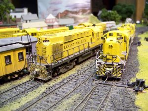

I always remoce any plastic cast on hand ladders and replace them with wire grab irons. I pant them very carefully with a fine brush being that the black would screw up the yellow paint as seen on this RS 11.
