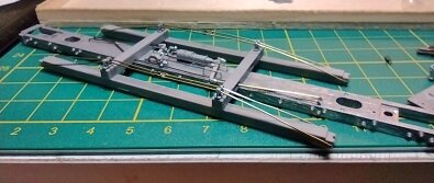

At this stage, the instr. sheet says stop, and get the truss structure built.
So that's where I'm at now, got the queen post and support rods in, what a process!
Need to finish the truss rod assembly, get the rods secured in the notches in the end of the truss frame.
Once I got the rod ends shaped to fit the notches, I gave them a dab of CA. To keep the rods in place while I did the other end, I installed the bunk and tied it to the frame. I am going to glue the bunks on, but that will be later.
Same thing here, glue rods in notches, install bunk, tie them together.
This will let me straighten the truss rods between the queen posts and ends. They are very soft. From queen post to queen post, the rods seem to have some kind of temper to them, certainly not from the queen post to the end! Anyway, I just wanted to get them reasonably straight before paint.
