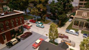

I do not permanently mount any structures to my layout. If I have a building, say a farm house sitting in grass, I'll set the building in place and put the grass right up to the building and some white glue will usually get up the the base of the structure and can easily be removed (if it's plastic). With wood structuers the grass goes down first and the building will set on top of the grass.
In the photo below, the street are made from "for sale" signs and glued to the plywood surface. The city blocks and sidewalks also made from heavier for sale signs are then glued to the streets. The buildings are then set onto the city block which have been scribed showing the seams in the sidewalks. The sidewalks in the park area and around the residences are also glued to the streets and the buildings set on top of the grass. At some time in the future I may want to light the interiors and that would be an easy fix.
