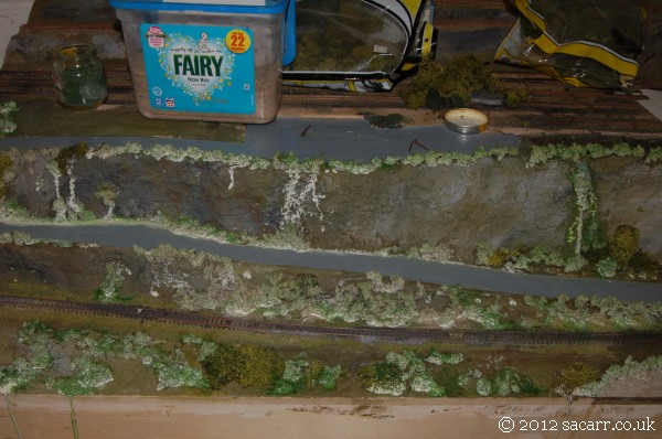

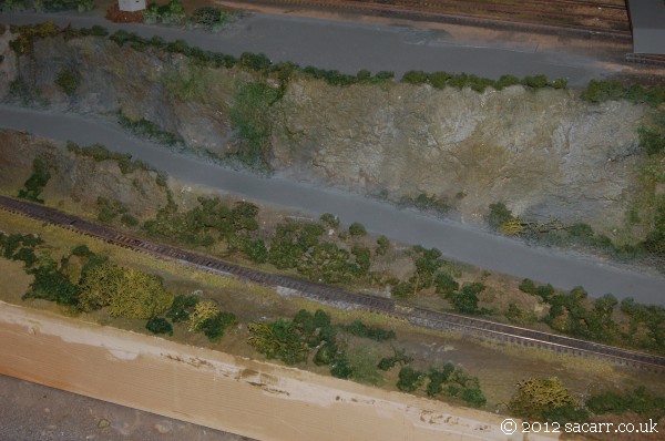

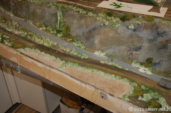

The road was given a first coat of grey paint and the level crossing check rails added. I then started to add greenery. Much of the clumpy foliage was pulled apart into small pieces and mixed with slightly diluted PVA glue. The pieces were scooped up on the end of a stiff brush and stippled into place. Over the top I added a light sprinkle of grass powder.

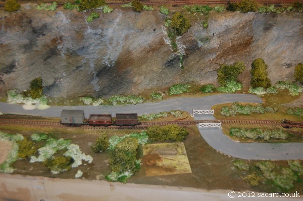

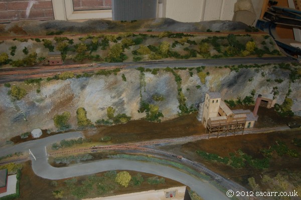

The road was painted again, and had an overspray speckle to break up the surface. This road was also blended into the road on the other section, and the hedge extended. The clay works were also fitted, and blended in with sand around the base.

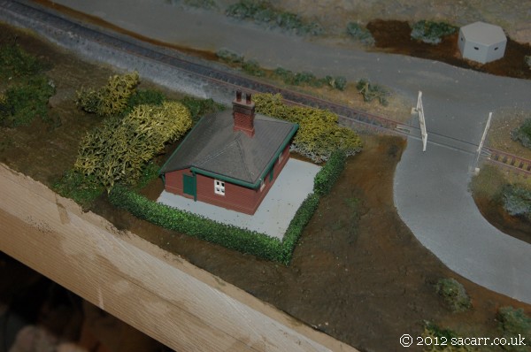

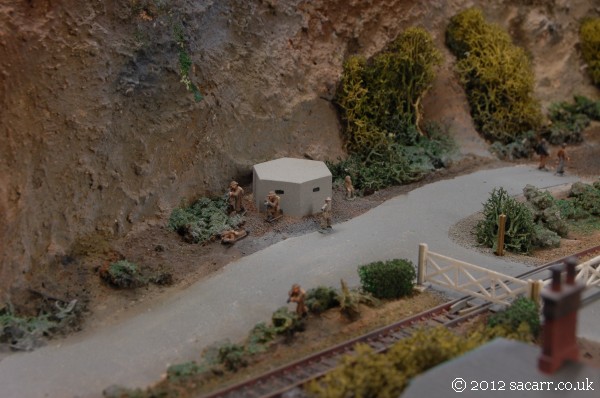

A pill box was added watching over the level crossing, and the base for the level crossing keepers house was painted.

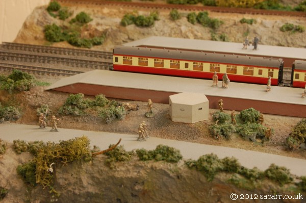

Another pill box was added near the station, watching over the approach road. The platforms in the background have also been painted, and just need their edging painted.

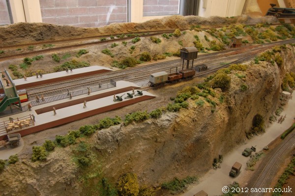

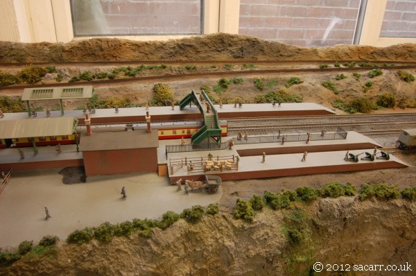

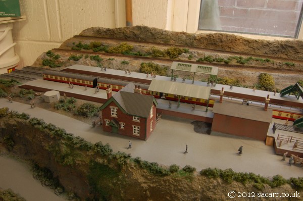

Here's a general view of the yard section leading into the country station section.

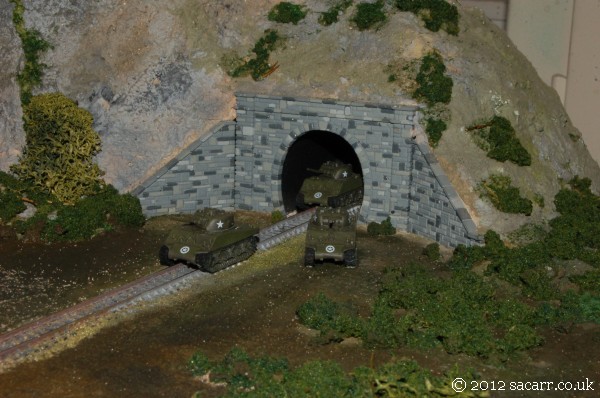

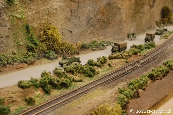

The Sherman tanks were also added in the little "Kelly's Heroes" tribute.
The level crossing keepers house was glued down and a hedge added around the property.
The platform edges were masked off and the edging stones painted. Once dry, the whole platform needs a speckle to break up the even finish of the grey.

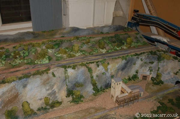

A general view of the clay works end of this section.

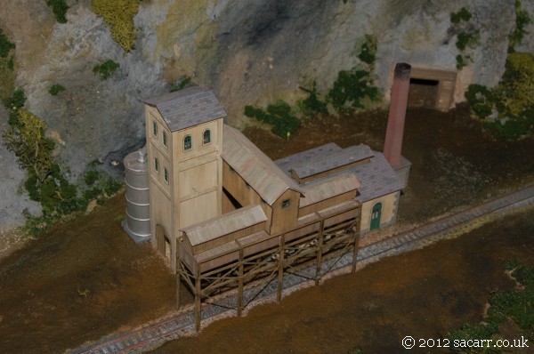

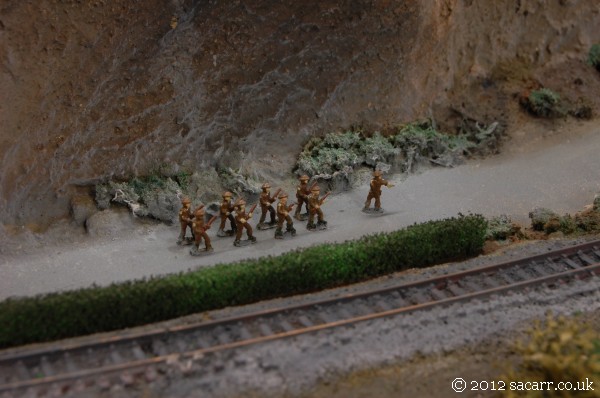

Last thing yesterday, the three platform sections were glued and weighted down to fully cure. Today's progress was mainly adding small details; figures, vehicles amd buildings. The clay works has a few people active around the building and some home guard troops are in exercises around the pill box.

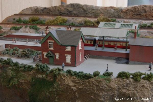

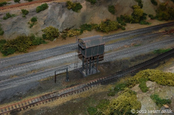

An old coal wagon has been added as a coal bunker, and a few people working around the area, and a busy station scene with the station masters house in the foreground.

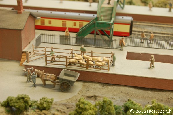

More troops are training around the upper pillbox. On the goods platform, there are now cattle pens, one of which contains sheep, and a fence separates the goods platform from the passenger area.

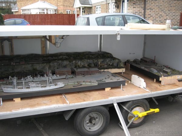

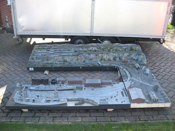

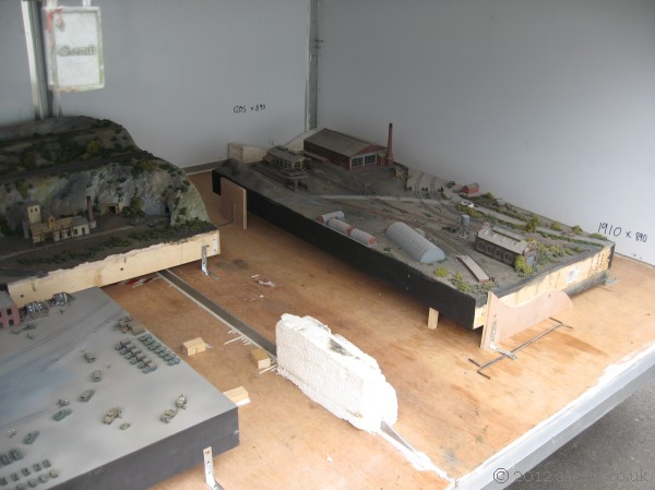

The three sections of the railway are going on holiday for a while later today. I need the workshop space for the strip down of the engine from the Jeep, and with the railway there, there just isn't the room to do both. The three sections have been screwed down to the floor of my trailer and will live in my dad's garage until the engine rebuild is done, and the engine is back in the chassis. Once that is done, the station section can come home briefly in order to build and link up the next section which is the first part of the airfield. Once the benchwork and track is aligned, the station will have to go away again to give me working space.

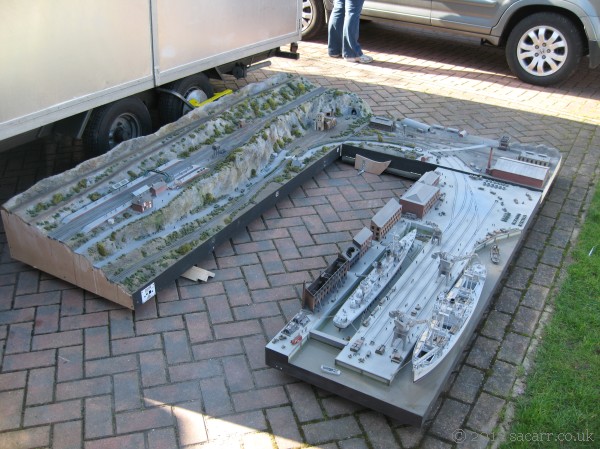

The layout made it safely to my dad's garage, but before it was packed away, I took these few pictures of the whole lot so far. I'm starting to get the idea of how big this will be! Another eight feet to add to the left of the station, and another four feet to the right for the mine, before the layout turns a corner!
