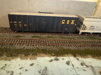

Received another car for myself from HomeShops.net for Bob Welke’s Wisconsin and Upper Michigan RR. Along with it being a great car from Rapido (shock there) Bob and his son Matt are 2 of the nicest guys I have met.
This will be lightly weathered, no graffiti or tagging
No no no look carefully my friend, there is dust, REAL dust on the roof grins.

Here’s one of my cars! A Rapido box car with a freelance road name for a friend’s railroad. The Wisconsin and Upper Michigan.
Started as usual:
I inspected the car, washed it in mild soap and water and let it dry overnight
Hit the entire car with a clear coat, using Tamiya xf86 thinned 50/50 with Tamiya’s x20a. Let dry about 60 minutes
The trucks and wheel faces were hand brushed with a mix of #301 Vallejo Panzer Aces light rust and #302 dark rust . Mixed 20% #301 added to 80% #302
The side panels were hand trimmed using Vallejo Air’s #.041 Burnt Umber straight no thinning
I then created a wash using the #302 dark rust from Vallejo Panzer Aces line of paint. Thinned with distilled water maybe 20% paint to 80% distilled water. Brushed on a few times waiting maybe 15 minutes between applications
The roof was done using #301 light rust from the Vallejo Panzer Aces line. Again as a wash 20% to 80%
My idea was to weather this up as a car showing the start of rust but as usual with my own stuff I may have gone to far
A work in process
Your thoughts please

Your first four photos show your goal was well-met. The others seem darker. Lighting, exposure, other side of car?
My toughest critic is my son and I sent him some pictures. He likes but asked, what about the wheels? Iused to rust the springs to make them noticeable and sometimes added a gloss black to represent grease on the roller bearings! So I went back and added rust to the springs and grease to the bearings.
Took some pictures and since this car does go through a hump yard the wheel rim needs to be cleaned up. But I noticed some voids in the wheel face
He also suggested leaving the roof but I will add something darker over the rust letting the rust show in spots
Took new pictures on a turntable so the light is constant. Couplers and pockets are next up and another spray of a clear coat. The roof will get another shading in the morning
