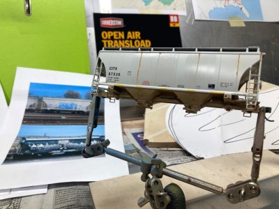

6. A quick spray of VMS gloss varnish is added before decal graffiti is added
7. I add decal graffiti but not the tags as I will custom write them
8. After a few hours of drying I will spray Tamiya xf86 flat clear varnish on the car

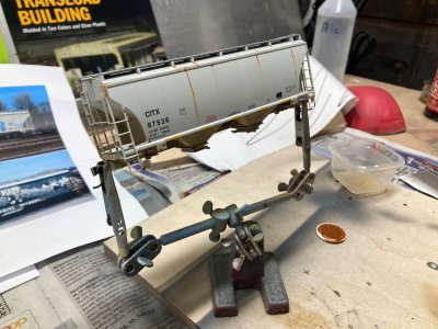

9. I will the spray the fade color. Usually for me I use Tamiya but for these 3 cars I will use Vallejo Air 71.001 white thinned to 30%paint to 70% Vallejo airbrush thinner #71.161, 3 drops of paint 7 drops of thinner will do these 3 cars
10. After the fade has dried I will create a wash of mineral spirits and Abteilung502’s Burnt Umber and with a flat brush brush the sides and underside of the car.
11. I will spray the car again with Tamiya’s flat clear varnish
12. After the car drys I will take and dab the Abteilung502 into my pallet touch a brush to hinges and obvious spots rust may be
13. The top of the car and hatches will have AK rust and dark steel pigments. The hatches if replaced are usually fiberglass and I would touch them up with a wash of Vallejo USAF light Gray thinned with water

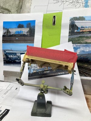

14. I will draw custom tags
15. If the client approves via pictures I will do a final spray coat of Tamiya flat clear
