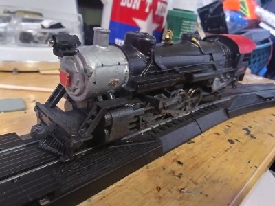

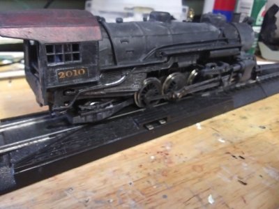

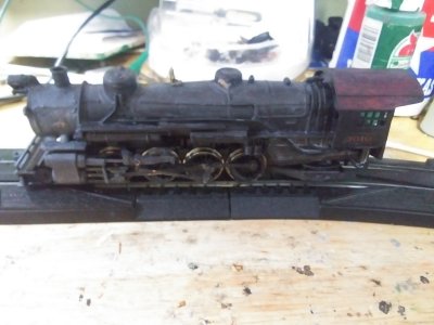

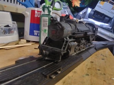

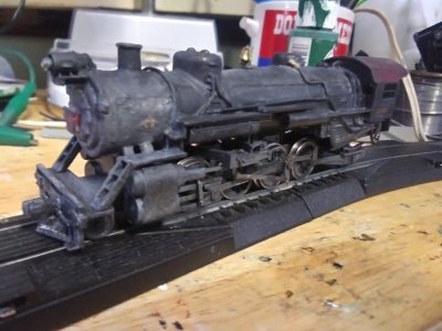

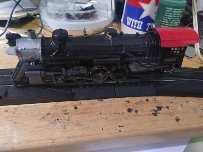

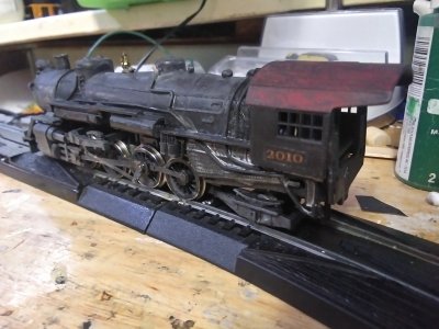

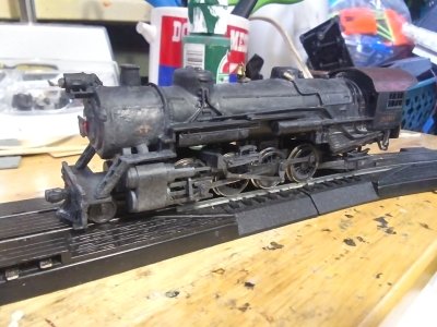

So guys, One of the engines I am weathering is my freelanced UP FEF (I will be posting photos soon). Thing is, it is in the Greyhound paint scheme, which is kept fairly clean (In some photos looks very glossy, probably because it is used for excursions). So should I weather it at all? I still think I want to give it a light weathering (Even though I cant find any good references), but what do you all think?
Not bad for my first "real" weathering, aye?
