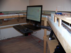

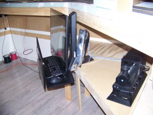

Finally got my layout computer installed (temporarily) in it's permanent home. The triangular section on which it is sitting is a separate "table" that can be unbolted and pulled out. I did this because I am not ready to start on the lower level yet but will need to get to the area behind the computer - thus the removable section.
As you can see the monitor support allows me to tuck the unit out of the way (somewhat) or position it for sitting or standing use.

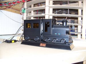

I also included a picture of the case I found to use for the computer - it only seemed right to have a railroad themed case for running a railroad. :p
Very glad to have this part done at last - you are a great source of motivation - thanks!
