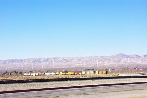

For starters, I would look at these two pages http://lariverrailroads.com/part2layout.html and http://lariverrailroads.com/mountains.html His layout is based on the San Fernando Valley and the Mojave Desert -- the scenery in the Valley, if you ignore the irrigated suburbs, isn't all that much different from the desert. I admire Pelle Soeborg's work (also based on the Mojave Desert), but he does use photo backdrops. I've found that books and web pages on how to paint landscapes, as well as the article Andy Sperandeo did 25 years ago in MR on painting a backdrop for his Santa Fe project layout, have been very helpful. One thing to keep in mind is that attention should be on the layout and models, not on the backdrop, so it's important not to get too hung up on painting details. (However, I would actually add a windmill farm in at least a corner!)
Here's an example of what prototype mountains look like in Pelle Soeborg territory, but including the windmill farm. The actual colors of the mountains vary widely by time of day.
Yes, that is what I'm looking to paint. I need to get an understanding of how to mix colors to acheive the different levels from purple distant mountains to the foreground. I agree on the details, that the backdrop should not be more interesting than the rail action.
