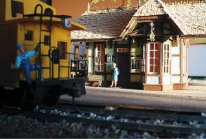

The texture turned out pretty rough on this one but that is ok:
Thank You---I used just some wash with water and a little black artist pigment. I might have put a couple drops of india ink in there too. I can't always remember what I did but this is one formula that I use. They also weathered quite a bit naturally because some sunlight was able to get into the room where this layout was.
