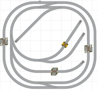

That would fit your layout, but I don't think any Legacy locomotive will run on a LionChief DC power supply. I would call Lionel and ask for clarification. 586-949-4100 or 800-454-6635
However, LionChief locomotives can run on AC power. I recommend a PH180 or GW180 AC Transformer. Two Legacy + up to two LionChief locomotives should be a comfortable load on a 180-Watt transformer.
If you want to have way more than enough power you can go with the ZW-L 620-Watt transformer.

Yeah, my eye site is failing so smaller scales won't cut it and G scale to big and costly. Once I'm 100% on the plan I will call them and see what they can recommend.
That is a versatile plan.
I would suggest a siding or two in the center, but what you have is great as is. Don't be surprised if you change your plan. I lost count long ago of how many times I changed my track plans.
When I had more free time i used to enjoy devolving plans in Any Rail. Most never saw the light of day but I had fun dreaming.
I'm already having second thoughts on it, I'd like to get a yard in there some how. I may look at it tonight, but then again I have another engine coming today. A lionchief PRR 2-6-2 Prairie. I can't wait.
As for yesterday's plan, I was going to say, shouldn't the present drop off be on the outside of the loops and the present pick up be inside with the tree? Or am I misunderstanding the reference.
The one you posted Monday wasn't bad.
