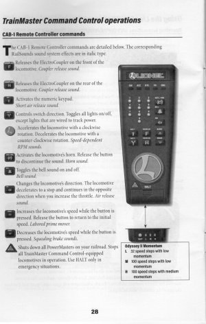

Well, I guess so far I don't have any or them. Well come to think of it. I do, the Polar Express Budd rail car was out long enough to test it. I kinda fell in love with that one. But not sure if all the lighting is correct. I do thank you for responding and trying to help me out!

Hey, thanks for chiming in! I was looking for the universal, but I'm kind of not fond of it. I may look at other options and see what the price range is before making a decision. At least know I know that'll it work!
I've tried the app, not sure I really like it, I thought you would be able to select multiple engine but you have to unlink the one you are using, which stops it. The app would be good if it permitted additional locomotives running at once. :)
Thanks again for the information at least now I know, just in case.
You could use the app to run the K4 and the universal remote to run three other trains and or the dedicated remotes that came with your sets
Without purchasing the Trainmaster Command Control System (TMCC), the remote in the photo won’t function. If you’re going to invest in a control system, I’d suggest opting for the Legacy system. TMCC was the original but has been replaced by Legacy. While TMCC can operate Legacy locomotives, some features will be missing. TMCC units are only available second-hand, and considering the price difference, Legacy is the better choice.

Yes, that's the universal remote! Although I suspect something funny is going on with that picture.
The "2-2-3" numbers directly under the "Shift" key should actually say "1-2-3". That would indicate the 3 different locos you could be running all at the same time. Not sure what's up with the 2-2-3? A.I. gobbledy-gook interpretation, perhaps? Or other?
Absolutely! Right on the money! The bigger the radius, the better. No matter what scale you choose.
And the same goes true for with switches (turnouts). The bigger the radius (or number) that you have room for, the better your trains will operate!
Yea I saw that and was thinking.. Thought only MTH made mistakes.. :) Also, This is what I've kind of been looking at, but can't find any of them around.

Lionel Cab-1L/Base-1L Command Set
Now you've introduced me to something I wasn't aware of!
After looking into it I will post more details for others, like me that had never heard of it.
The CAB‑1L/Base‑1L system debuted in Lionel’s 2013–2014 catalog cycle. That was the moment Lionel introduced the “L” series; a modernized, simplified successor to the original TMCC CAB‑1, designed to give operators a lower‑cost entry point into command control without buying the full Legacy 990 set.
The CAB‑1L/Base‑1L was marketed as “Legacy Lite”; Legacy‑compatible, TMCC‑compatible, but without the advanced CAB‑2 screen or deep menu functions. By the 2016–2017 catalog, the set was still offered. After that, it quietly left the lineup as Lionel shifted toward LionChief, Bluetooth, and Base‑3.
