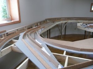

Really coming together. You're thinking along the right lines to leave the subroadbed in place and connected while you put in the risers. As most commercial bridge/viaduct kits are designed with level track (don't know of any that aren't, but there may be), leaving it all connected with temporary supports across where the gaps will be, enables you to get the vertical transitions on each end to match where necessary. There are prototype trestles etc on grades and curves, so keep that in mind as well.

Nice video. Those rail cars really squeal around the bend. Mullan Pass is not far from where we live. I have noticed many of the trestles and viaducts in our region look very similar to the one shown on the video. I am leaning that direction for my layout.
There was also a bit of a not so much ulterior motive (apart from the MRL one, that was purely ulterior), there will come times in your build when you'll question "Will I ever get done?" Just refer back to the video, with the volume up, when you need a booster.
Yes, it will be a long haul. But I am in no hurry. It is as much about the journey as the destination. Getting some trains up and running will be a big mile stone. Thanks for the encouragement. :D

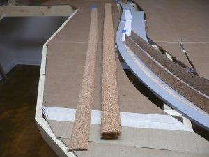

I got my road bed cut, except for the turnouts. I ordered a 4ft x 25ft 1/4 inch thick sheet of cork from Home Depot. It is meant to put under hardwood or laminate flooring. The total cost of the sheet delivered was $78.00. I have a lot left over for turnouts, industry and staging expansion. It worked out to be quite a bit less than ordering the model railroad cork that is pre cut. I cut 1 3/4 inch by 4 ft sections with a utility knife, then ran the long edges through the table saw with the blade set to 45 degrees to get the beveled edge. I will have to slice the sections meant to go around the curves down the middle to get them to bend, but that will be no trouble. The straight or nearly straight sections are good to go. I laid the cork around the layout on edge to see how much I would need.
Looking good, sir. Well done.
...I cut 1 3/4 inch by 4 ft sections with a utility knife, then ran the long edges through the table saw with the blade set to 45 degrees to get the beveled edge...
You might be able to save yourself a little time, and material, by cutting your strips at the angle to begin with. That way you don't have to bring it back to the table saw every time.
The original sheet was 4 ft by 25 ft, too big to run through the saw. The 1 and 3/4 inch strips ran through easily. I suppose I could have ran through sections of 20 inches or so by 4 feet and cut them at the proper angle, but they are all cut now.

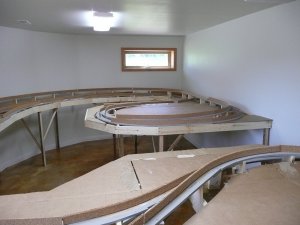

Amazing progress Greg! I love following a layout from planning stage to finish, or at least till trains start running! I'll be watching this thread!
Nice work Greg. I really enjoy watching a layout come together. Also liked the video Toot posted. I have gone up to Mullan Pass a number of times to watch train climb the grade. Not very far from me.
I will be watching this thread to watch your progress.
Thanks to everyone for your input and encouragement. :) I probably won't get much more done on the layout until this fall. Our lives tend to move outdoors for the warm summer months.
Getting back to the railroad. Just finished up laying the cork sub-roadbed on the main lines, except under the turnouts. Now I am ready to spend some money on Peco track and turnouts. The big question is what type of turnouts do I get isolated or electrified frog turnouts?
