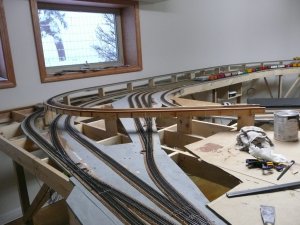

Sorry to ask the question a second time, but to me it appears there are sections where the track is laid onto a 'blue' subroadbed. with cork roadbed just below that. I see other sections where it is obvious the subroadbed is plywood (and in wood color). Now I do have to admit to being slightly colorblind, but I think I definitely see blue material under some of the track work??

The blue or gray roadbed is painted plywood, on top of that is cork, on top of the cork are my tracks. There are no tracks laid directly on the plywood. But not all of my tracks are laid yet. I still have to add the loco round house area, the staging yard, and the town area. Those areas don't even have the plywood subroadbed yet.

Ah ha...blue painted plywood rather than blue foam. I knew i had lost some of my eyesight, but was hoping I had not gone total color blind....ha...ha

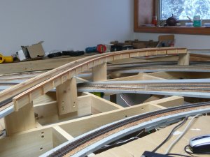

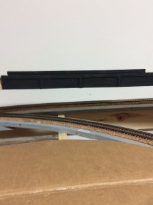

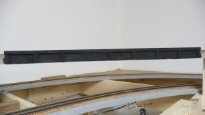

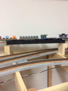

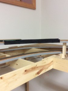

Then I put together some rail road over passes. I was going for a girder bridge look. I know the real thing is made in straight sections, but I cheated and went with a curved section. I would like to pick up some kind of steel looking supports with some kind of abutments.
The painted black bridge was very difficult to photograph as I couldn't get the ribs to show up. They just fade into the background. But the unpainted bridge shows the ribs plainly.
Edit: Tried to get a better pic of the bridge painted black.

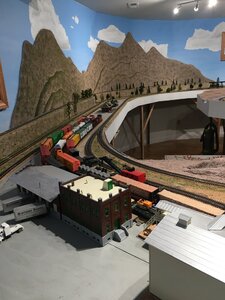

Update:
I have been working on the locomotive yard. I have a few more tracks to lay around the turntable. But I have the turntable in as well as the roundhouse, machine shop, water tower, coaling station, sanding stations, diesel fueling station, and ash pit and tower.
Question: I and going to need to scenic the ground to cover the cork sheeting. What are some good ways to do that?

Just started putting the first layer of "gravel" in my loco and freight yard. I used the fines screened out of a bag of Quick Crete pre-mixed cement. First I removed all of the buildings and structures that were not permanently affixed to to layout. Then I masked the tracks and other structures that could not be removed. I laid down a thick layer of white glue thinned with water to make it spread easier and sprinkled on the "gravel". When it dries I will go over it again with another coat of "gravel" to cover any light spots. Then I want to apply some Wodland Scenics fine ballast cinders on top. This will give the gravel a darker coal and oil stained look. The subsequent coats of "gravel" and cinders will be set in place with a 4 to 1 ratio of white glue and water applied with a turkey baster.
Note: The darker gravel next to the roundhouse is a different color than the other gravel as it is still wet.
Any other ideas on how I can finish off the gravel to make it look like a transition era rail yard?

I finished installing the gravel in my loco and freight yards. I made sure to seal all of the cement. I ended up using 4 cans of cheap hairspray, and totally saturated the cement with it. It didn't kick up the dust, and did a good job of penetrating and permeating the fines. It dried solid.
Pros to this project:
  1. It was very cheap less than$25.00 for the Quick Crete and hair spray.
  2. It turned out great.
Cons:
  1. The cement dust is unhealthy to breath.
  2. The layout smells like a beauty shop, but that will dissipate in time.

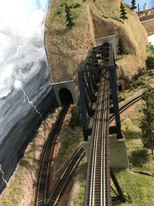

Right now I am in the process of replacing the bridge over the yard with combination of a truss bridge and a steel viaduct. I have some of the viaducts built. They are placed on top of the rails now to get an idea of how I will trim the ends to fit the curve.
