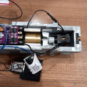

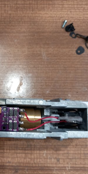

As I said previously I installed the decoder with the dead amplifier in a Stewart F7B unit. I removed it from a Kato GE dash9-44CW.
The decoder, a Blunami PNP8 was loaded with GE sounds. With its dead amplifier it still usable, without sounds, for any other loco using
PNP8 decoder. Such is the case for the Stewart F7B unit.
Later on I'll equip a F7A, also from Stewart, with a PNP8 decoder loaded with EMD sounds.

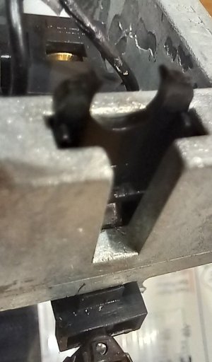

The original Stewart DC board is very easy to remove. Also, no weight in the way to remove.
I just soldered the two front and two rear rail pick-ups, and top and bottom motor contacts. That's it, I don't plan any lights on this B unit.
1974 : After removal of the DC board, and the now "silent" decoder ready.
1975 : I glued some thin pieces of Evergreen to avoid any contact with the frame.
The decoder rests on a small square of double sided tape.
1976 : I installed a small piece of double sided tape between the two soldered rear cables, so they can't touch each other.
I'll install a current keeper later on.

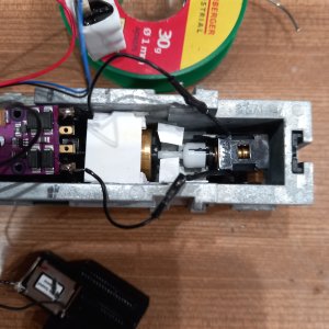

Can the decoder be wrapped? Some recommend not to for heat, but wrapping the decoder ensures no contact with the frame or anything.
Sincerely I don't know. I prefer to put one or two small pieces of double sided tape underneath, so it holds it in place and nothing can touch below.
I added thin Evergreen left and right because the frame is so high on the Stewart model. On other models there is no risk since it's surrounded by a plastic shell.
I use another small piece of double sided tape to hold the ultra flat speaker on top of the decoder, so there is no contact possible.
I also don't want to cover the Bluetooth chip, but is it important ?? The Blunami 2200 is totally wrapped in plastic, so...

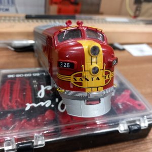

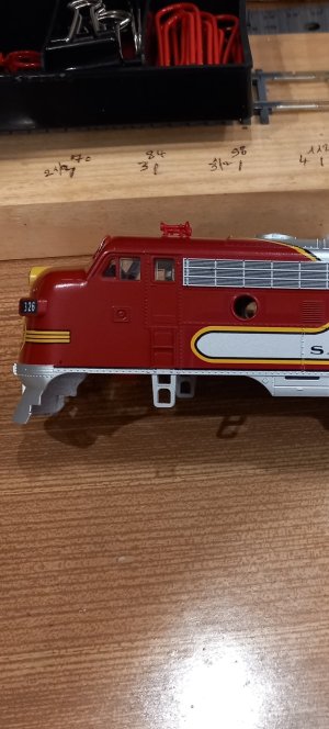

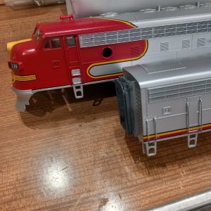

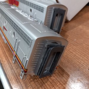

While waiting I decided to add details to those locos. Several years ago I installed wipers and American Limited diaphragms on both units.
I also painted the horns, I didn't like their plastic look. Then I put them back in their boxes for the future.
I now wanted to add all the vertical handrails and grabs these locos lack. I hesitated for a long time since it's quite a work.

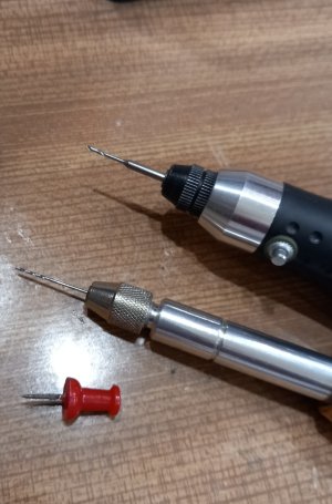

There are a total of 34 pieces to form, different sizes, and 68 holes to drill !! 36 on the A unit and 36 on the B unit (only vertical handrails on B).
I used very stiff and thin metal wire formed with pliers and cut to size. There are VERY tiny marks on the shells, so I drilled the holes in three
steps : first a push-pin to accentuate the marks, then I made pilot holes with a hand drill, then I pierced the holes using my small Proxxon
power drill, hoping I wouldn't make a mess.
I painted everything before installation. I also painted some details on the body, like fuel fillers, marker lights and so on.
I also painted the diaphragms dark grey, they were very light grey, wayyy too light.
Attached : The tools, and some before and after photos.

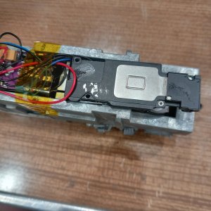

I prepared the decoder, installed it on two small pieces of double sided tape, and connected the wires : rails pick up, motor, front light
and speaker. With the decoder moved toward the front and after cutting off the plastic rear "light support" (useless in the A unit), I could then install the Scale Sound speaker easily.
This speaker is thought for those Stewart F7A units. First time for me, I wanted to compare the sound with my ultraflat speakers.
I plugged the current keeper and guessed it could sit on the front part of the decoder.
WRONG ! Impossible to put the body shell back on ! Gasp !
1984/85 : The plastic light support shaved off.
1986 : The finished installation that actually doesn't work !

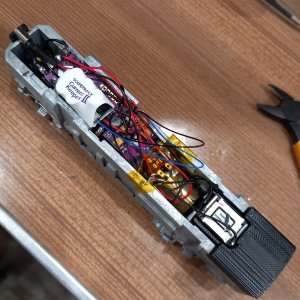

I decided to build some kind of platform for the current keeper between the decoder and the speaker, just above the rear flywheel.
But even so I could not totally put the shell back on. I had to admit there isn't enough room for both, speaker and current keeper.
Well ! I removed the speaker, installed the current keeper on top of the rear "tower", and connected an ultra flat speaker which sits
on top of the current keeper with a thin piece of double sided tape.
I have two of those SSS speakers, hopefully I'll find locos with room for them.
1987/88 : Building the (useless) platform.
1989/90 : Current keeper finally installed, and the speaker on top of it.

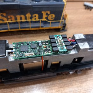

Hello everybody.
Recently I bought for a good price a Proto 2000 GP30, it looks pretty good and was weathered by the previous owner.
I plan to install a Blunami decoder and a speaker.
I opened it and, see the photos, this is how it was equiped, there is an 8 pin plug.
I don’t understand what I see, help will be appreciated.
Sorry for my lack of knowledge.
What you see in the pics is the Proto2000 8-pin wiring harness "on top", with what looks to me to be a (not "factory installed") dcc decoder "underneath".
Have you tried running it on dcc?
If it IS a decoder (certainly looks far more complicated than a factory installed light board would look), and the engine runs well with it (even without sound), why not just leave it in place?

Zooming on the 1st photo shows a Digitrax component.
You are right, it could very well be a decoder on which the original harness is plugged.
Now I have to see what Blunami could fit and find room for a current keeper and a speaker.
It gonna be tight !
Thank's again for your help.

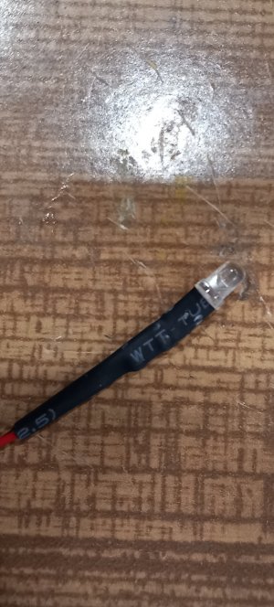

I have some diode equiped leds (photo 1903), could I use them to replace the original bulbs which don't look like leds ?
I thank you beforehand.

For the LED, since it already has a resistor built in, that makes it easy. From your photo, that arrow is pin 1. It should have an orange wire on it. Pin 2 is where you'll connect the tail light LED -. Pin 6 is for the headlight LED -. Pin 7 is for the head and tail light LED +.
