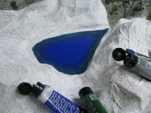

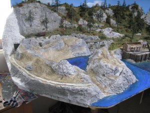

On the PCM&T Co. layout I wanted a clear mountain lake. My sky is blue so I will paint the bottom blue, but I won't stop there. Many folks just slap some blue paint and add their 'water' product. Wrong! If you want a believeable pond or lake try it this way:

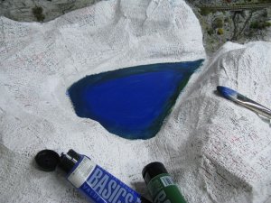

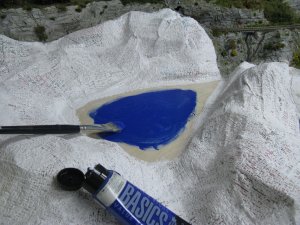

First in the middle paint your primary color. In this case blue.

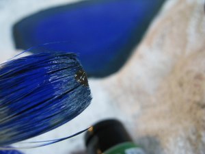

Second is some green around the edges. This helps portray the shallowing of your pond. IMPORTANT POINT: Do Not wash your brush between applications of new color. Reason: The major stumbling block to painting pond and lake bottoms is blending in the colors. By not washing your brush this job of blending becomes fun and quite doable. So, all the way through this tutorial just add paint to the brush no washing.

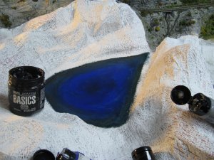

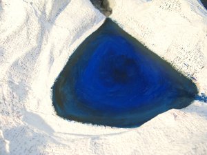

Third, Add some gray to the green edge area.
