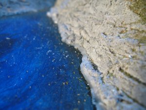

One of the problems with using 'water' products on our layouts is that when you pour them they find the unsealed spots and drip out on to the floor. They all do it and here is the cure.
I use clear silicone sealant around my pond/lake edges. Assuming you use plywood for the bottom of your lake/pond then if you apply clear silicone around the edges you build a barrier to keep the 'water' from creeping. Try it you will like it. The water products blend in with the silicone. Jim:)
Is there any time limit to applying the 'water' to make sure you get adhesion between the 2? Is it better to use a non-acid cure silicone?
I'm looking at the tube of silicone and see nothing about acids. Coming from the boating world I've used silicone all my life and never heard of acid issues. I use GE waterproof silicone, (kitchen/bath/plumbing). It is ready to go in 3 hours and mold free.
There is no interaction between and of the many 'water' products and this silicone. Once dried and cured (over night) it blends in very nicely with 'water' products. This is much easier way to seal ponds, lakes, streams and river banks. The best thing is it contains the 'creep' common to all 'water' products. Jim :)
The reason I asked is because there are 2 types of silicones available, the Acetic acid cure and neutral (non-acid) cure. The latter is the one used where there could be a chance of interaction with the product being sealed and is the safest if there is any chance of such occuring. The one you are using, being for use on plumbing etc, would be the neutral cure type.

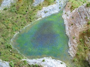

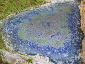

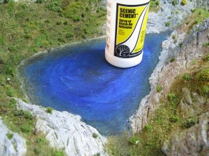

Now as promised: A better way to do ponds/lakes?
I think so. First, paint your pond/lake bottom blue. No art stuff here just paint it. Let dry overnight. Second, spray the bottom with spray glue. Move the glue to the sides with your finger.
Third, add fine ground foams to the bottom. Darker first, to show depth, the lighter colors out to the sides. I used brown for the shallows near the shore. You can do this anyway you want. Be sure to blend/overlap your shakes.
Best part is you don't have to be an artist. Darker to lighter, it doesn't get easier, or more realistic when the 'water' is added than this method. Elapsed time from first photo to last 4 minutes. Jim:)
RRunner, No problem. Ground foams are a generic term for the wall of ground covering foam bits for coloring your terrain at your LHS. Looking at the name of these items I guess I should have used the word 'turfs.' Jim:)

The scenic cement Jim, is that a "white" glue (PVA) of the type that can be thinned with water, as I note you say to move it to the sides with your finger, not something you could do with a contact cement.
Reason for asking is because I can't say I've seen a spray variety here (although easy enough to thin a bit if it's that type and put into a pump spray bottle) apart fom the rubber contact variety.
RR130, I figured you had it. The great thing about turfs is that you can blend them for many color combinations. No fuss, no muss. For murky ponds brown and burnt grass colors are best. Jim:)
Toot, I don't see PVA listed on the WS Spray Glue. I have only used this product since I started model railroading. An alternative I've heard about is diluting Elmer's white glue about 50/50 with water. It is a cheaper alternative. I'm not sure if it clogs sprayers any more than WS Spray Glue does. I think the important part here is that you need a white glue that is water soluable and dries clear. There must be more than one brand in Oz. Jim:)

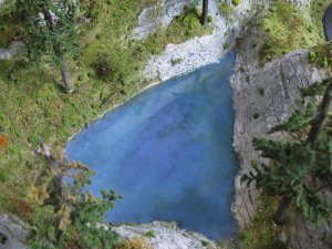

Here's the first pour of Woodland Scenics Realistic Water. I will probably do three pours. When this is all dry it will look great. I don't like the Magic Water and other two-part 'waters' because they are crystal clear. Realistic Water has some opaque quality that I find more appealing. Jim:)

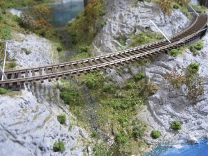

Here is an update/progress photo I took yesterday. I love small streams and creeks. Here a photo of the outflow from the lake in the middle background without water in it. This photo is not complete yet either. Just thought I would take this photo. Jim:)
