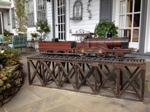

My father gave me this model sometime in the 1980’s. It came with a framed sign that said something to the effect that “this train was displayed at the 1893 Chicago World’s Fair”. No documentation of its history was offered, and I suspect a dealer somewhere along the sales chain became creative, but I really have no idea.
The engine weighs over 37 pounds and the tender is upwards of 24 pounds! The locomotive is about 38” by 9 1/2 “ square, and 14” tall. It is displayed on a 6 foot long wood trestle that is 21” of the ground, so it looks really cool “riding the rails.”

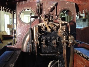

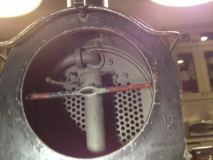

Some of the detail is quite remarkable. Look at the backhead and the inside of the smoke box!

Hi. The loco looks British but with a cab like that it looks like British built for India.

I would call this a salesman's model. Something that sales people would carry around to demonstrate to prospective buyers.
That would explain the intricate detail and superb craftsmanship. Anyone selling (or buying) steam locomotives would definitely be "upper crust"

Colin, are you referring to the cab sides being open perhaps meaning it was meant for India?
Yes, that and the fancy roof edges.
As you say British locos have enclosed sides for some weather protection ( except very early locos ) .
I said Indian but on reflection it could have been for any hot colonial country.

The large driving wheels with curved wheel spats makes me think that is a model of an early British built Engine my guess is pre-1900's . It has English Chain and buffer couplers and looks to be standard or broad gauge. That would rule out some of the colonies.
It could be a Egyptian state railways class 401 built by Neilson and Co of Glasgow

I would say you've hit the nail on the head there, certainly the open air cab is a definite clue. How'd you find that one. I bet the BBC 1 TV program "The Antiques Roadshow" would love to have that model on one of their programs (bit hard to get it to them though). Needs a specialist antiques valuer for it.

This one really has me curious. It looks a lot like a live steam locomotive, especially when viewed from inside the cab. Some of the items in that are not to scale, but are sized as if it was a live steamer.
On the other hand, the smokebox end looks like it's made for small boiler tubes. However, they also don't actually look to be there. Is this a screen in front of the actual boiler area? Are there boiler tubes, or can you see all the way through the boiler, which would, of course, mean it doesn't hold water and so could not be live steam?
That's exactly what I thought. The tube sheet (where the ends of the boiler tubes would be) looks as though you can see behind it as if there were no tubes, just holes. Also, there is no indication of the tubes being rolled (the way boiler tubes are sealed to the tube sheet) which should show as a flared end at the tube openings.
