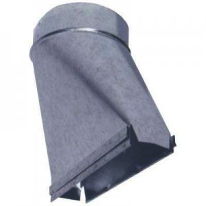

Using a few HAVC parts and ducting, a muffin fan, and wood to make the booth. You can make a reasonability nice paint booth, add a light in the top of the box even better. Just another means to an end.
greg
For 89 bucks looks like the paint fumes blow back into the users face ?
greg
The ducting is intended to connect to outside - I guess the person who took the picture didn't understand how to set it up.
Mine is NOT setup like that.
Frederick
