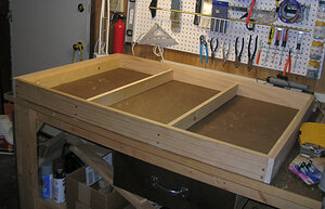

The layout is constructed on top of a simple open frame.
For the sub-roadbed, I start with a layer of thin plywood on the bottom followed by a layer of 3/4-inch blue foam on top of the plywood. Cork roadbed and track are glued to the foam. Everything is held together by cheap latex caulk:
Although the plywood is probably not necessary for structural purposes, it provides a solid place to mount switch machines, circuit boards, wiring blocks, and the like.

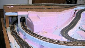

I use blocks of pink foam as risers to provide grades. You can see them in the photo of the naked (unscenicked) layout below.

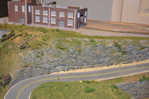

I also used foam for landforms. I stacked slabs of foam and glued them together with caulk. Then I carved and shaped the foam with simple tools. Finally, I painted the carved foam and added details.
In summary, foam has worked well for me!
