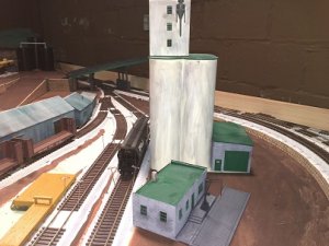

I am taking my first stab at airbrushing structures:
I used Apple Barrel acrylic paints shot through a Paasche double action airbrush. I am pleased with the initial results. I experimented with Dullcote and another craft acrylic sealer on these structures. I want to weather with washes and eventually use chalks or powders. I like the texture affect of the chalks and powders.

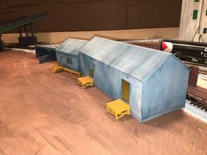

I appreciate the advice and suggestions. I wanted to post a few before/after pictures of my first efforts. This is after five washes with different shades of grey. I plan on using a couple different shades of brown. I used craft acrylic paints with 70%alcohol
