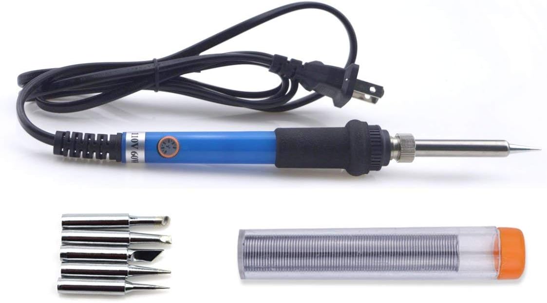

I'm thinking of getting this Soldering Iron Amazon.com: GLE2016 Electric Soldering Iron Kit 60W Adjustable Temperature Welding Soldering Iron with 5pcs Different Tips, 1 Solder Wire 1.0mm Dia. (Soldering Irons): Home Improvement.
At least that's what I think I want.

Okay gang I got some more money from my mother and decided to go ahead and order the Soldering Kit after all! https://www.amazon.com/gp/aw/d/B07G...c=1&uh_it=e608cf45c6549b01c354a05a1b4fcbae_CT Now I don't have to wait as long anymore.
I did only just want the soldering gun itself but I figured eventually I was going to need the rest of the stuff so I decided to do what would help me in the long run and buy what I need all at once!
Besides it comes with heat-shrink tubes and in different colors so I can make one lead one color and the other another (e.g. one black lead and the other lead red!) That'll make it easier, at least for unmarried bulbs! I say "unmarried" because I'm also doing married lights (this came from the term used on multiple unit type trains, EMUs and DMUs, like NICTD's EMU trains, they use married pairs.) My "married bulbs" are bulbs with one lead per bulb jointed together while the remaining leads remain stand-alone, these are the bulbs I plan to make flash alternately with the signal lights.
The kit also comes with solder wire, something else I will need! And comes with other tools I just might find useful, for my upcoming project and for other things unrelated to this that may need these tools!
I also went ahead and ordered rosin soldering flux paste, I ordered this because it was one of the least expensive ones on Amazon https://www.amazon.com/gp/aw/d/B07F9HBCT9?ref=ppx_pt2_mob_b_prod_image It won't be here till June 1-22 though but now I shall have soldering liquid! (@McLeod)
I'm happier than a lark!...so far, let's see what these really are and if they'll work when they come!
