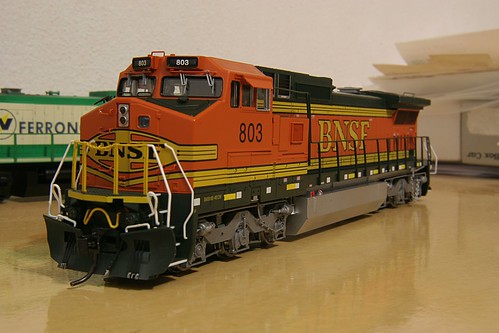

I don't think you can get them without a plow. It's the thing at the front bottom of the locomotive just above the tracks and around the coupler that looks like a ... plow. It has a square hole on each side for the hoses and cables to fit through.
That's an atlas model.
The bachmann model may not have one

While the Atlas version clearly hs a plow on it,

DOES NOT appear to have a plow on it at all.

NOr does this version appear to have a plow.
