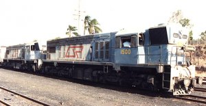

Here's a pic of QR's 1460 class with their nose "snorters"
I think those had the dynamics in the short hood.
I remember some high short hood GP 38 and 40 series units heading to Mexico with steam generators in the short hood, but most just had the toilet and odds & ends in there.
Yes I would say it is the dynamic brake grid and cooler, you can see the fan shroud on top. The ones with a toilet in there would have always run long hood forward?
