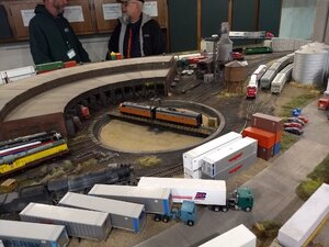

This sounds like the one my club has. It has forgotten its programming twice and is frequently broken. I believe it gets over-used by steam enthusiasts. There's talk of rebuilding the movement with home-engineered solutions.
Notice my Mikado, not on a turntable track. I've never, ever used the thing myself. The F's may be orange but they aren't mine.
