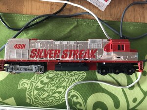

Hi, Everyone. Recently, I pulled out my old train set from when I was a kid. I have a 4x8 piece of plywood and excited to get rolling again. Plugged it in, set up the track, and then remembered the engine stopped working years ago. The light comes on, but it makes no noise. So, I found another one online and ordered it along with some more track. Guess what? The engine does the same thing! Light, but no movement or sound.
I know that the track and power does work as I have another engine that moves around the track with the power on.
So, I am wondering two things:
1) Has anyone ever repaired this defective engine?
2) Is there a place I can send it to repair them?
Thank you for any advice.

If you hear nothing from the motor but lights come on, I'd pull the shell off and make sure a wire didn't break loose from the motor. If you don't see a broken wire, with the shell off, you can put it on the track and see, the motor may be running but the connectors (plastic) to the wheels may have broken. This is unlikely as you'd still hear the whir of the motor, but doesn't hurt to verify.
1. No, but sounds like a broken wire or motor brush. Is the photo you showed the original loco or the one you just got? As I recall those locos have the motor mounted on one of the trucks.
The motor does appear to be inside the middle area, but it is not easily removable like another engine I have. I will have to try and pull it apart.
