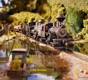

I've modeled a swamp section on my HO scale modules. Cut a depression in the plywood base and added plywood underneath the hole. Laid the track and poured in Envirotex Lite up to the level of the rail. A tricky proposition, as the Envirotex is fairly thick and flows slowly, I didn't want it to go over the rails. More or less it, added foliage around the swamp, an abandoned truck, etc.
