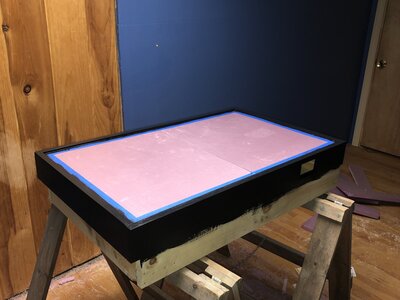

Once again I’ve been inspired by Steve from stevestrains.com and have opted to paint the benchwork black. I really like the look of it! I should hopefully have time tomorrow to get it painted, at least the first coat anyways.
I’ve applied the first coat of paint. Very happy with how it looks! In the next day or two I’ll apply another coat.
As you can see in the pic, I’ve utilized my “prototype” benchwork as a table to hold up the actual benchwork itself while I paint it haha. That’s about the best use I could come up with for it.
Applied another coat of paint and I’ll add a third for good measure. I also cut out and drilled a section of hardboard for the toggle switch panel. It came out a little rough but I’ll clean it up with some sandpaper. I will be painting this black as well.
