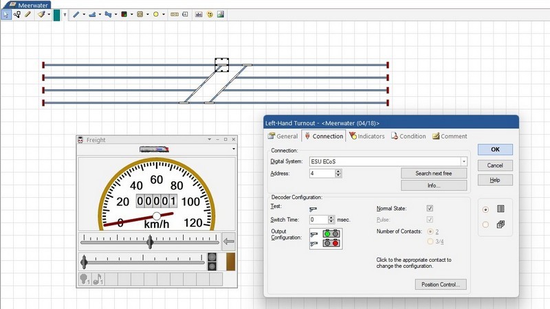

Traincontroller 10 was released September 2022. It seemed like a good moment to start a new series of videos.
Video 1 shows how to download and install TC, how to get a license code and activate it, how to connect your Digital System and how to control a train with a Train Window.
Link to video Traincontroller 10 Gold 01 Install and Drive a Train

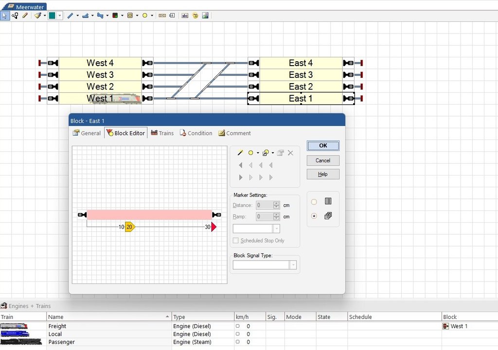

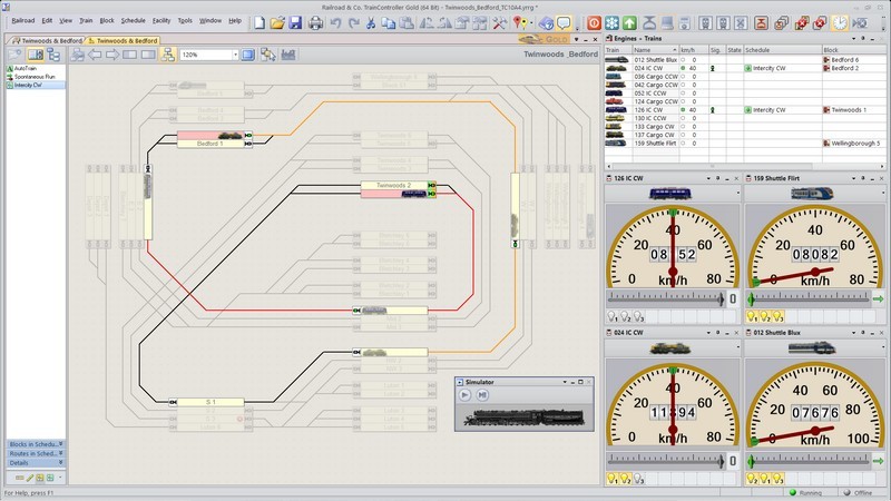

Traincontroller 10 Gold 03 Blocks and Sensors for Train Detection
So far we can drive a train (video 1) and we can switch turnouts (video 2), all manually. To enable automatic train control we’ll need to create blocks. Similar to a real railway, trains drive from block to block and they’ll be halted by a red signal if the next block is occupied.
At the entry of a block a track sensor detects a passing train (reed switch) or the presence of a train (current detection). Each sensor has an address. Traincontroller continuously monitors the sensors, at all times it knows which train is in which block on the layout.
Link to video Traincontroller 10 Gold 03 Blocks and Sensors

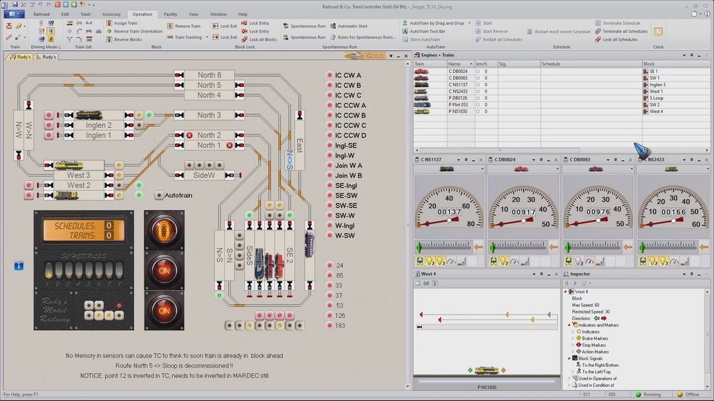

Traincontroller 10 Gold 04 Automatic Driving
There are a handful of different ways to drive trains around on a layout, whereby TC switches the turnouts and signals and accelerates and decelerates the trains fully automatically:
- Autotrain by Drag & Drop. Drive from A to B
- Spontaneous Run. TC decides randomly where the trains will go.
- Autotrain Toolbar. Drive from A to B with more options, among which to store the Schedule for later use
- Schedules. User-created paths that can have multiple departure- and destination blocks.
Link to video Traincontroller 10 Gold 04 Automatic Driving

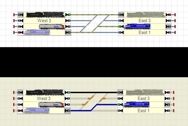

Traincontroller 10 Gold 05 User Interface
The TC user interface can be modified to your personal preferences in many ways:
- Overall color scheme
- Menu and toolbars
- Window sizes and floating / docking / tabbed behavior
- Use multiple monitors
Link to video Traincontroller 10 Gold 05 User Interface

Traincontroller 10 Gold 07 Customize the Train Window
The Train Window can be customized. Colors can be changed and sliders and buttons can be sized or hidden. The gauge can be made ‘sensitive’, which means it can be clicked and the train will accelerate or decelerate to the speed that was clicked.
Link to video Traincontroller 10 Gold 07 Customize the Train Window

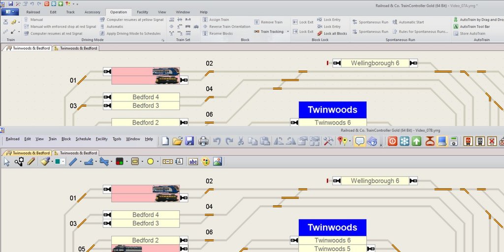

Traincontroller 10 Gold 08 Classic User Interface
Standaard is de gebruikersinterface in 'ribbon' stijl. Het ribbon menu werd jaren geleden geïntroduceerd door Microsoft, in hun Office-suite. Hoewel het een veelheid aan klikbare links per ribbon biedt, vind ik het nadeel dat dingen moeilijker te vinden zijn en dat er vaker naar een ander ribbon moet worden overgeschakeld, waardoor juist meer muisklikken nodig zijn in plaats van minder.
Gelukkig is de UI 'oude stijl' nog steeds beschikbaar. Deze heeft de klassieke toolbars met klikbare iconen. Het grote voordeel is dat iconen uit verschillende menu's / ribbons kunnen worden gecombineerd in één werkbalk, wat leidt tot minder muisklikken. Het is mijn favoriete manier van werken.
De video laat zien hoe de klassieke UI kan worden ingeschakeld en hoe deze kan worden aangepast.
Link naar video Traincontroller 10 Gold 08 Classic User Interface

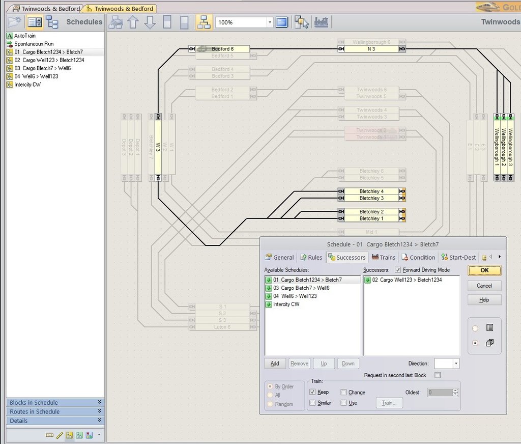

Traincontroller 10 Gold 10 Schedule Types and -Successors
Once a train has reached the destination block of a Schedule, it will be taken out of the list and the trains will come to a stop. If we want the train to repeat the Schedule, or to start a different Schedule, we have to change the Schedule Type, or add Schedule Successors. The video shows how.
Link to video Traincontroller 10 Gold 10 Schedule Types and _Successors
