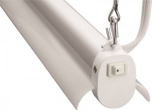

8 LED shop lites for $62
8 four-foot long LED lights, and linkable, all for $62
These are the latest 'shop style' lites I found at Amazon,...
(Pack of 8) LED T5 Integrated Single Fixture 4FT,20W,2200lm,6500K (Super Bright White),Utility led Shop Light, LED Ceiling light and Under Cabinet Light
https://www.amazon.com/gp/product/B076FQ15R6/ref=ox_sc_act_title_2?smid=A1KZKP85O3COJ&psc=1
That's less than $10 per lite, and they are linkable,..
