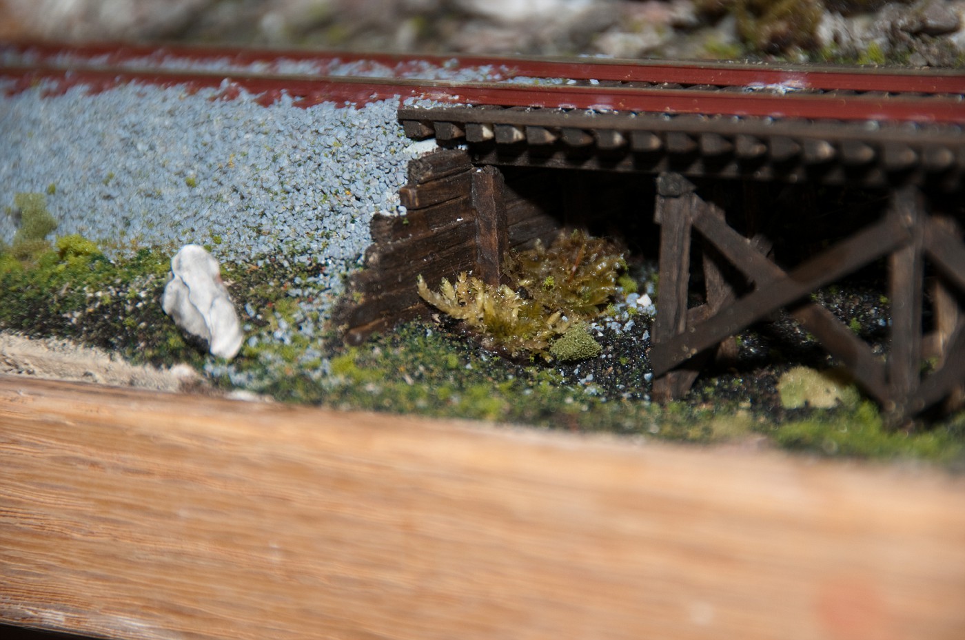

exactly the thing. i use foam for my terra-forming and cover it with drywall joint compound to cover the roughness and unwanted dents. i use latex paint however, cheapest wallmart one. friendlier to work with sticks well enough to both plaster and bare foam (scuffed with sandpaper actually). then before the paint dries you can sprincle it with ground-cover, either store bought or hand made . i use both: WS ground foam products and earth i sifted and baked a bit in the oven.
i used moss (preserved in alcohol/glycerin solution) from my backyard for vegetation BTW, i like it better then clump foliage of WS
