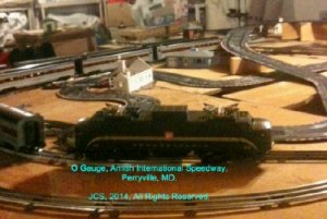

Here's a photo of the 'Amish International Speedway, Perryville, MD, Layout,' I have in mind. I'm using 027 and 054 curves at this point. It covers an area of 10'x10' or there abouts. Trains will be mainly PRR equipment. The racetrack is a 1:43 SCX set, with a few extra pieces thrown in.

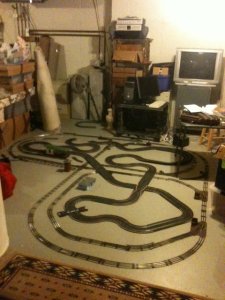

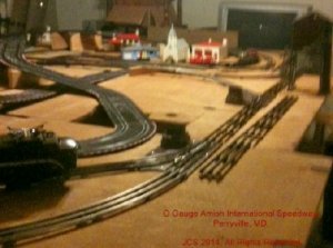

The SCX will be part of the layout, yes. Here are 2 photos from this weekend. Perryville, MD, left, and right. In the distance in the left picture will be a hill, with a farm on it, and a train tunnel thru it. A station will go in the area of the wye tracks, just like the real Perryville. Good progress for 2 days. Got to do some structural work, then paint the plywood, plant grass, flowers, etc...
