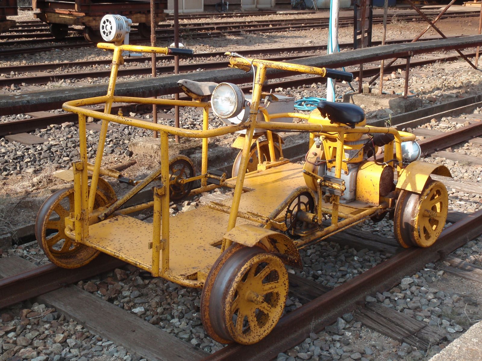

Or go a little fancier and build a pedal powered speeder with a backup engine ("hybrid") for when you get tired :D
