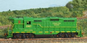

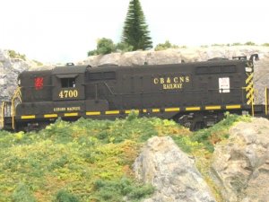

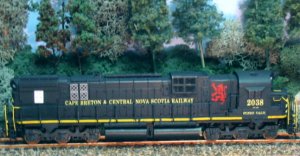

Well the way I do it is float them in place (water) then use the corner of a paper towel, Kleenex whatever to siphon the water away. Then let it dry. It's still tedious but it will work. The locos that were painted in CB&CNS colors had names. I have three locos that I had to do that way and a couple of the names required letters that weren't in the decal sets but I made them up with pieces of other letters. It does take some patience but it does work.
The GP-9 is "EDMOND TAVERNER"; The GP18 is GERARD MAC NEIL; and the MLW C630 is STEPHEN VALLIS (a friend who came up with the idea of building the MLW's from Tyco models
Cheers and good luck
