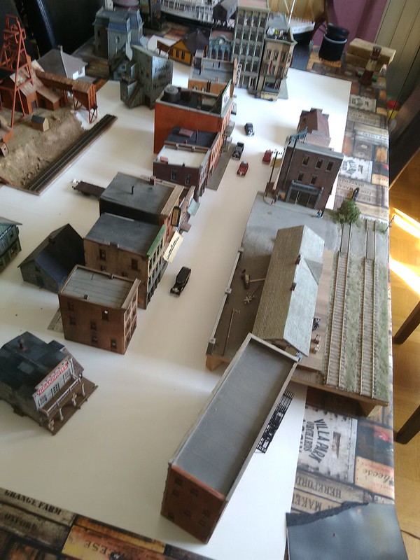

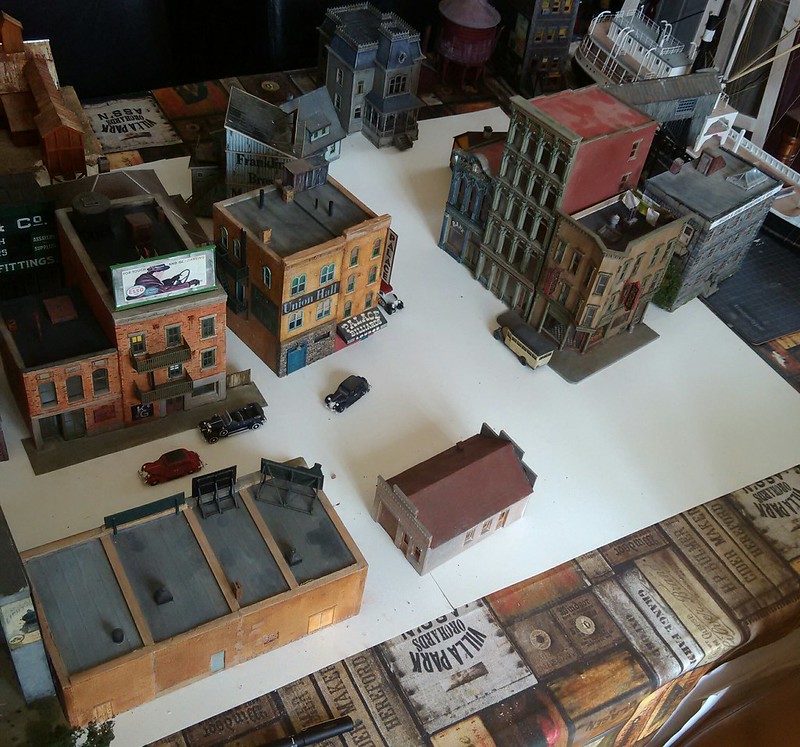

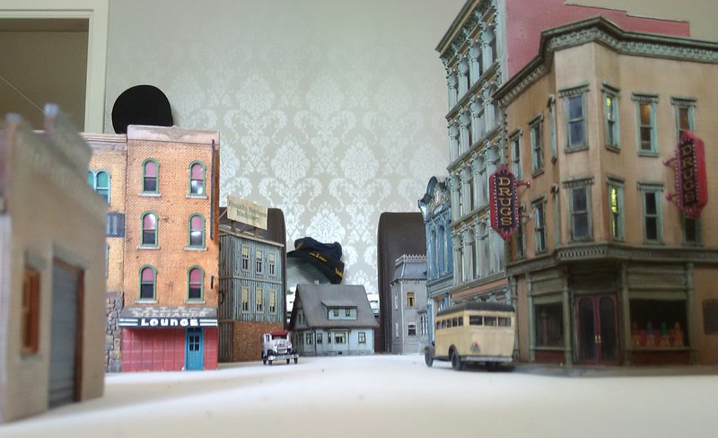

To prepare, I've been doing some city planning for one of the towns, called Twin Peaks (work name, yet to be decided)
IMG_20170518_110214 by Michael Graff, on Flickr
Main Street, the town will be 8' long.
The station will be regauged to HOn3.
IMG_20170518_110240 by Michael Graff, on Flickr
IMG_20170518_104830 by Michael Graff, on Flickr
IMG_20170518_110137 by Michael Graff, on Flickr
The street will go upwards in the back and turn into suburbs.

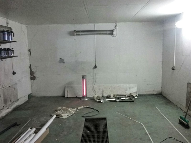

I've actually managed to clear out the space for the layout.

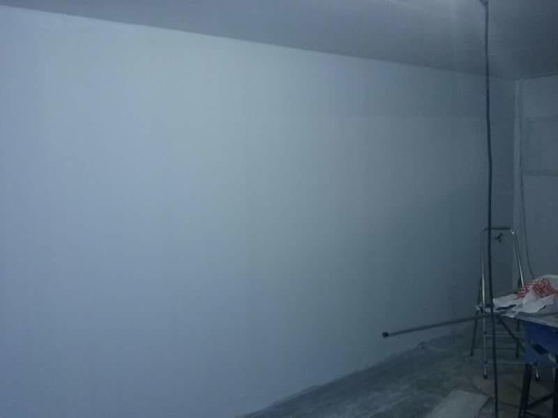

The room as it looked...

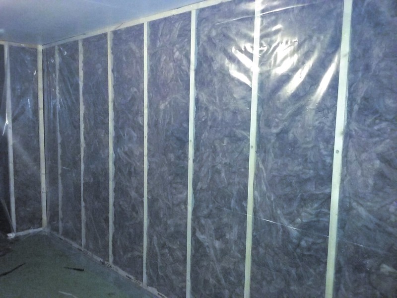

Insulation and moisture barrier installed.

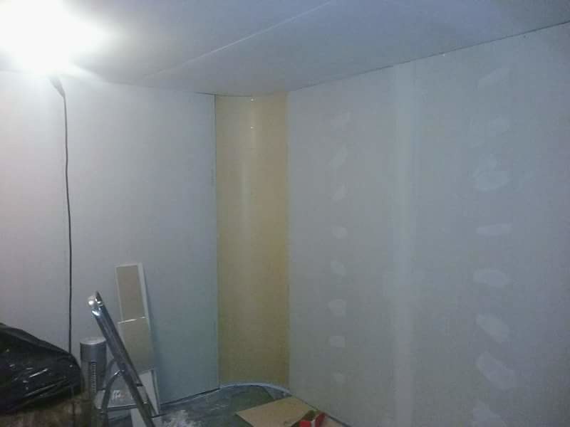

Sheetrock... We all love to do some sheetrock and mud and sanding, and mud and sanding....
I rounded two of the corners. I made a backing from two layers of 1/8" hardboard.
I used 1/4" sheetrock that I wetted and bent to shape in the corners.
The backdrop is now the next step (almost..)
I need to install the lighting first.
I painted a test piece just to see the colors and tonal values.
It needs to be toned down a bit though.
More like this test:

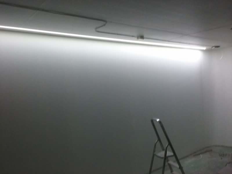

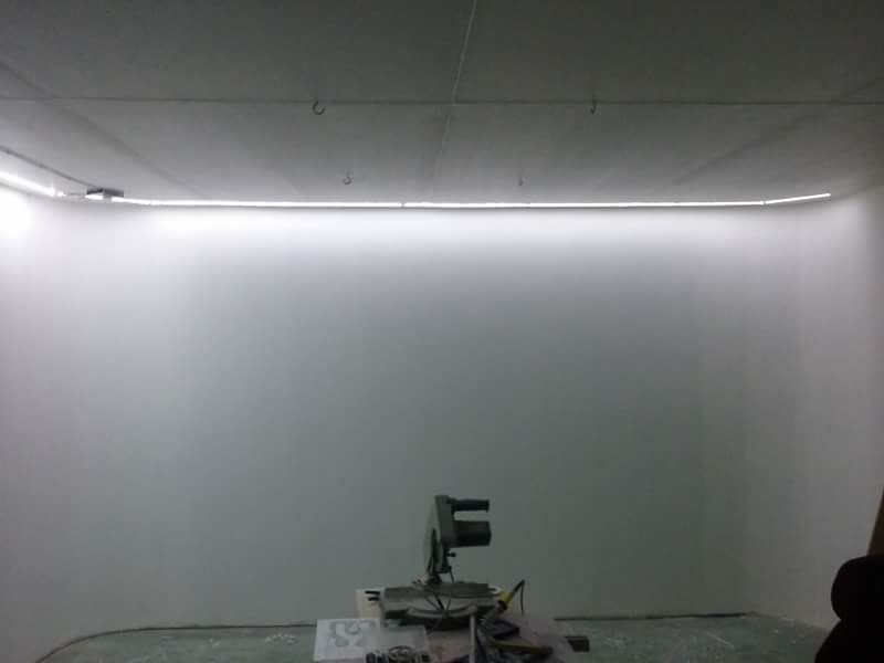

I've ordered the carpet and all the LED light fixtures, so it's finally getting there.
Let there be light!

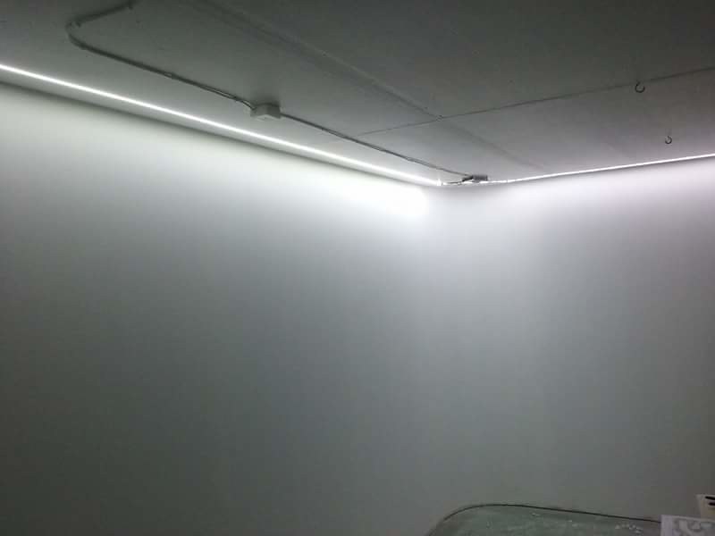

First LED strip in place in the train room.
There'll be double rows, the other angled 20 degrees to the wall.
Fill lighting will be with LED spotlights.
Can be okay in the end.

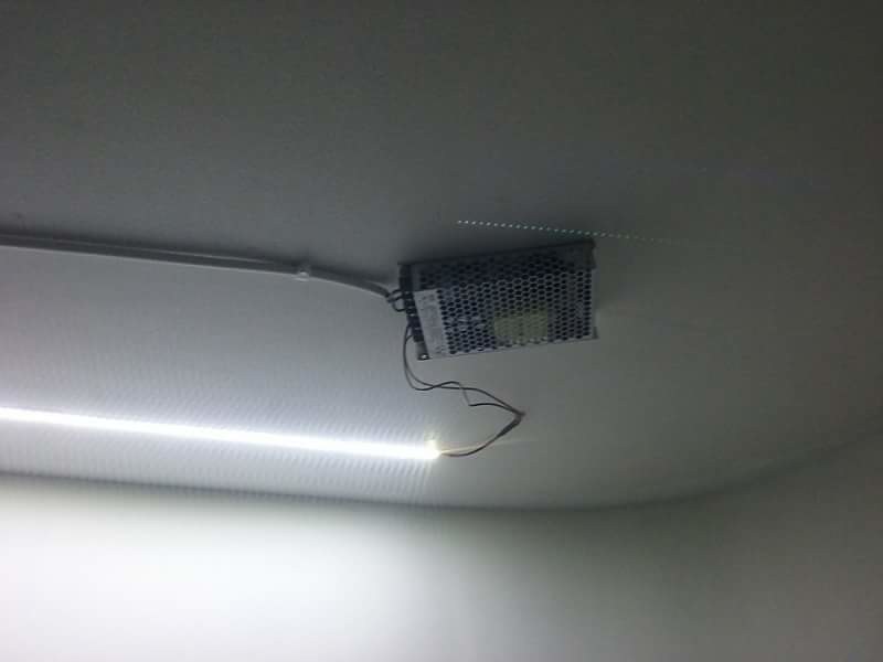

The switched power supplies I use are from Mean well, 12 V and 18 Amps.
They are adjustable between 11.4 V and 12.2 V.
The LED strips are rated at 12 Watt per metre and are 5 metres in length.
4800 K in temperature.
Installed the second LED strip today.
The light level will probably be okay when I can install the outer LED strips as well.
I have to build the valance first, so it'll be in the right places.
My plan is to have the valance about 2-3" outside of the layouts edge.
The LED strips has a 40° light angle will be mounted 20° inward so it will light straight down at the front, and towards the backdrop.

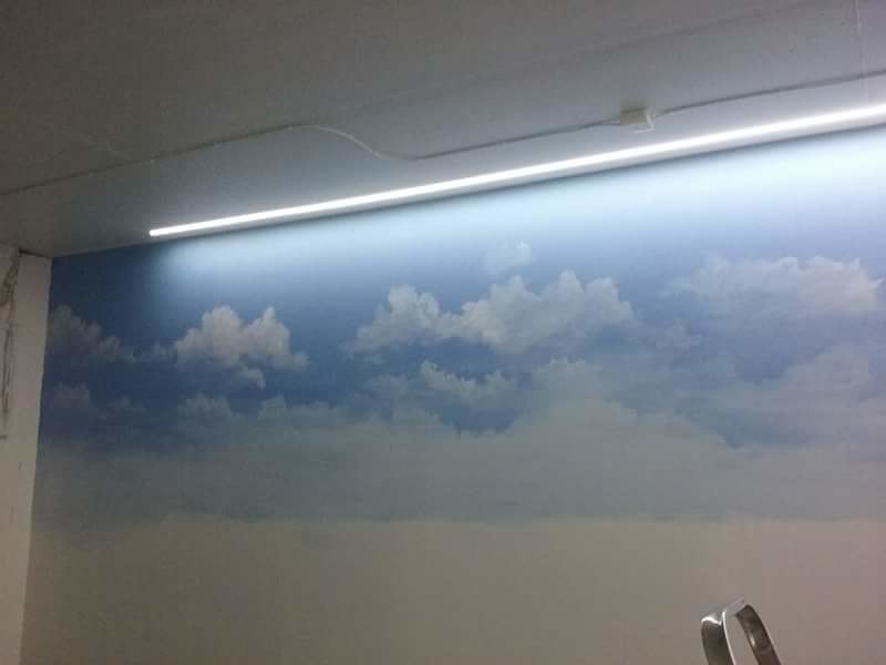

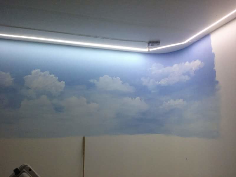

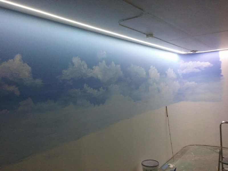

Started the backdrop painting. One wall is sky painted with clouds.
The backdrop is 60' long and 4'6" tall. I use regular wall paints.
I will wait a bit to paint the landscape until after I've started the benchwork.
