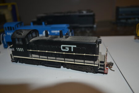

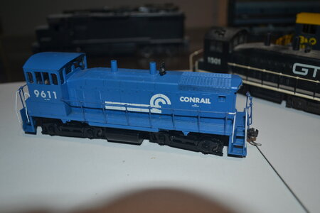

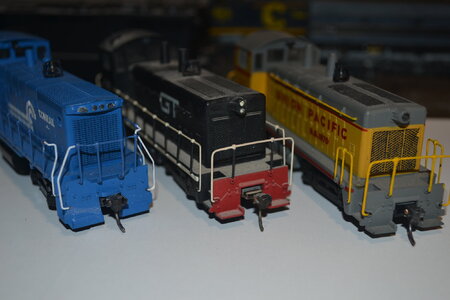

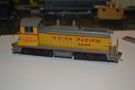

Chris here I'll confuse you a bit more The Conrail is a SW1500 The GT is a SW7 and so is the Union Pacific all three are athearn
Notice the headlights are all different and so are the handrails
Athearn called their early SW7 a SW1500 Then they did also have a SW1000 (single exhaust stack) I think I have one somewhere

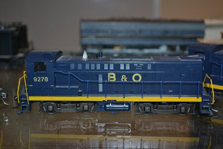

Thanks, I've found an Athearn S12 bodyshell for the second chassis, I'm told it will fit, I'll do the same with this one once I get the paint marks off, seemingly it's a private RR so when I get it I'll see if I can pin it down a bit more. Then I can return them to their owner.
