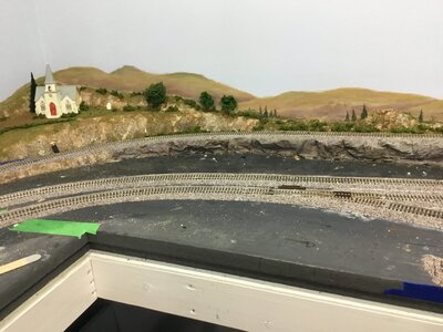

Update:
Rock face added above the track in this corner with the church scene. Also the rock face to the right below the back track painted a darker grey colour.
Another corner with the repainted cliff face. Plans are to add some lighter rust and ochre shades over this base coat.
The third corner with repainted cliff face which is still a work in progress.
