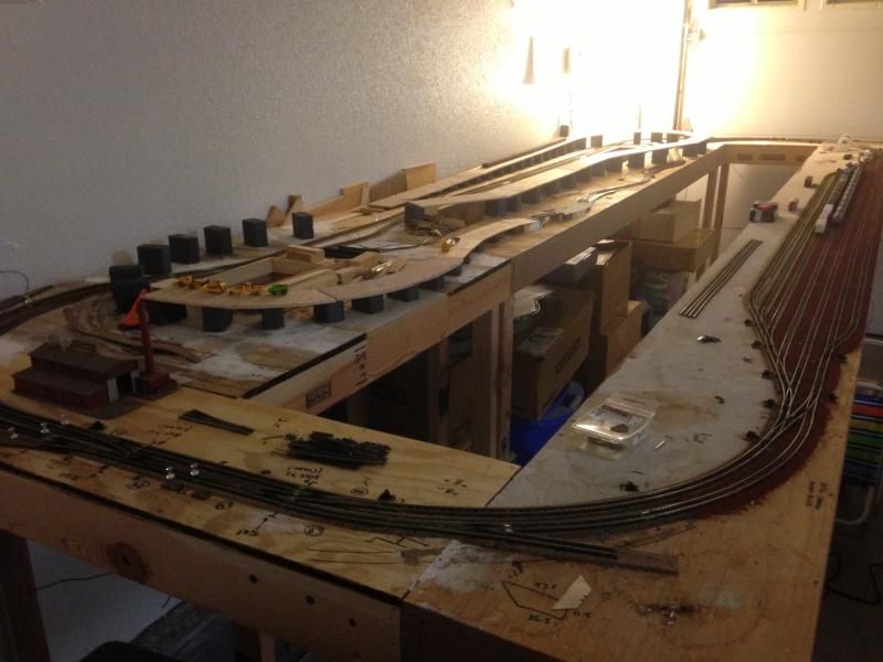

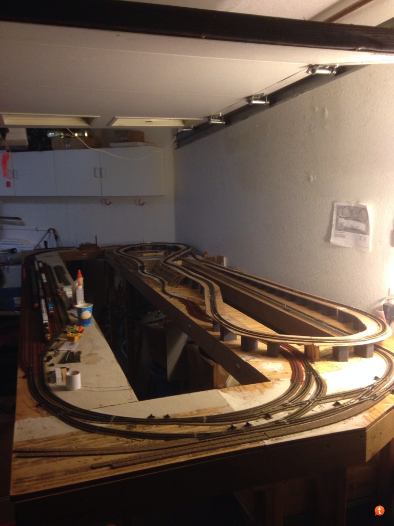

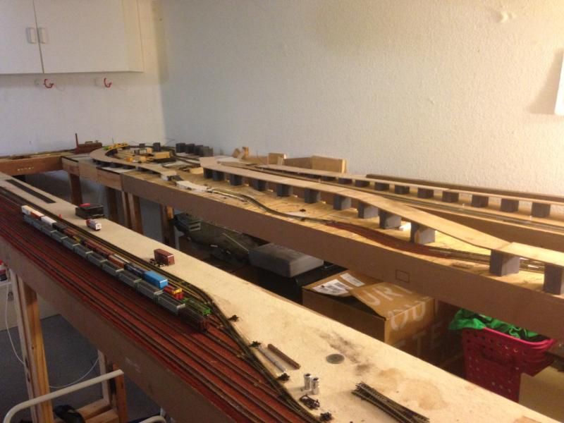

Hello all, I am new to this forum and glad to be a part of it. I am looking forward to learning from others and picking up great tools/tips to incorporate into my layout as it takes shape. This is technically my first layout, I started this layout several years ago as a project for my son and I and really haven't had too much success with getting it running due to being in the military and having to tear down due to moving/deploying! I have finally been able to start making some progress with it this last year and I thought I would share now for feedback and just to track progress of the layout.
The layout is being modeled after BNSF Southern California operations during the BN/ATSF merger era. The layout finally has running trains and switches that work and I still have some wiring to do for the yard. This is the first section of what will eventually have a larger yard and another city/industrial section that are not built at this time. I haven't started any scenery yet other than playing around with ballasting some tracks and prepping some hills for "plastering".

May 2013:
- Putting back the layout sections previously built back together and incorporating new sections/benchwork to use in the section of the garage allocated for my layout....

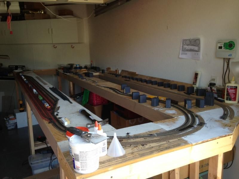

September 2013:
- Cutting/adding the pillars for what will be an elevated track dogbone through mountains...
November 2013:
- Completed track on west end and installing base material for elevated track through mountains.
February 2014:
- Elevated track complete and operation, but still have some bugs to work out (I'll post some videos shortly). Starting to play around with building up hillsides for plastering and creating scenery for the mountains.

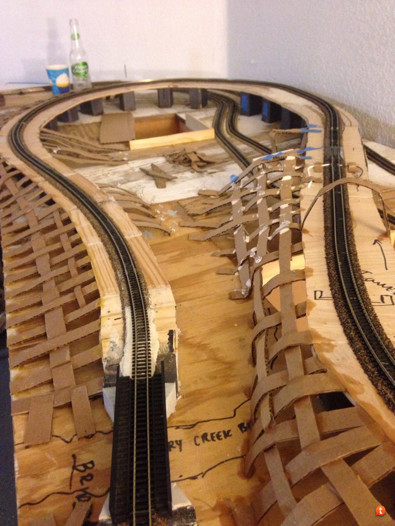

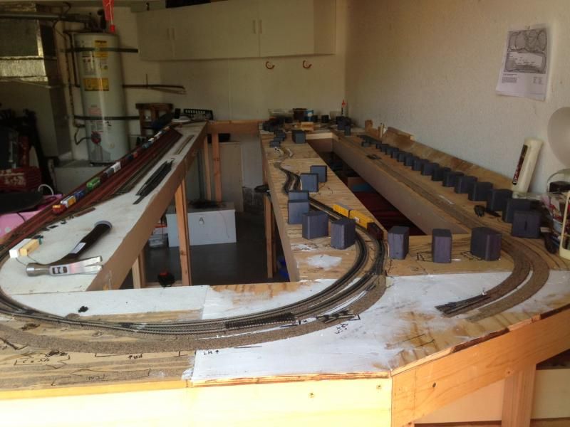

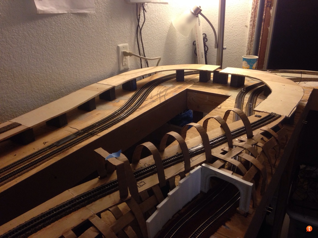

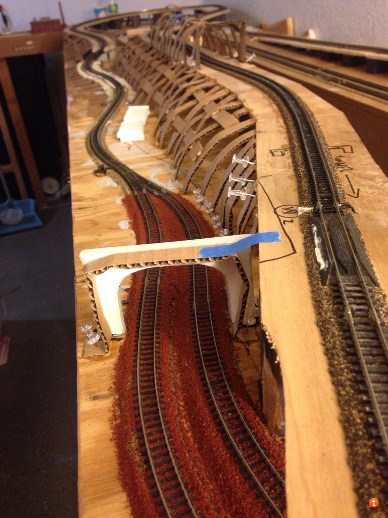

A few shots of some mountain and scenery buildup today...
Still got a lot of work to do! I was trying to upload a couple videos via taptalk but it won't let me so I guess I'll have to do so via photobucket or YouTube tomorrow.
Thanks for looking!

Steve, are those pillars made from 2x4's or something else?
They are actually sections of 1x2 wood I painted, cut and tapered the tops to allow for the incline/decline of the track. Probably not the most commonly used method of benchwork!

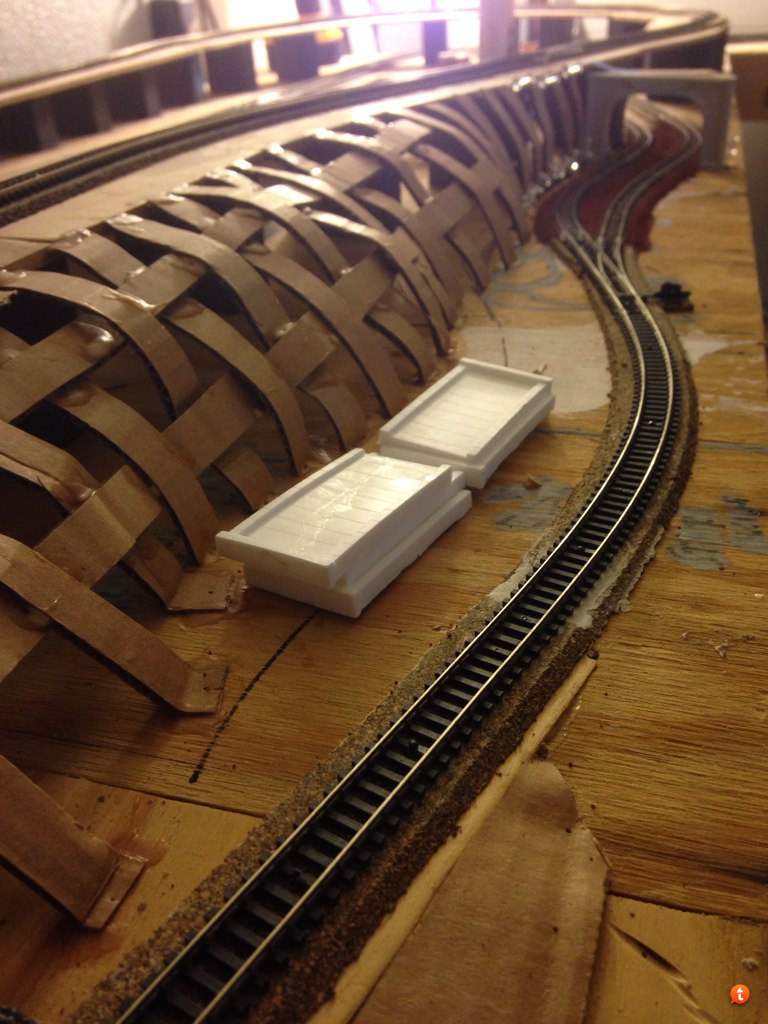

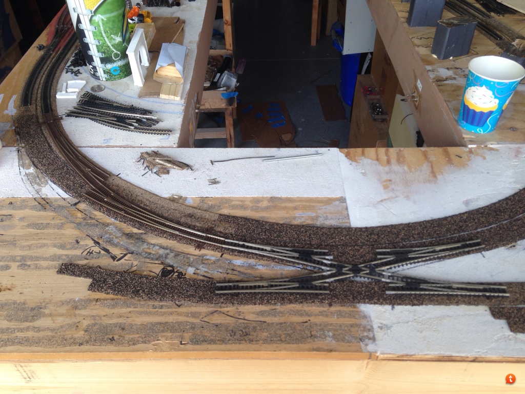

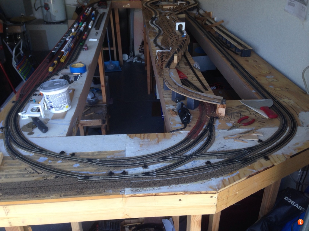

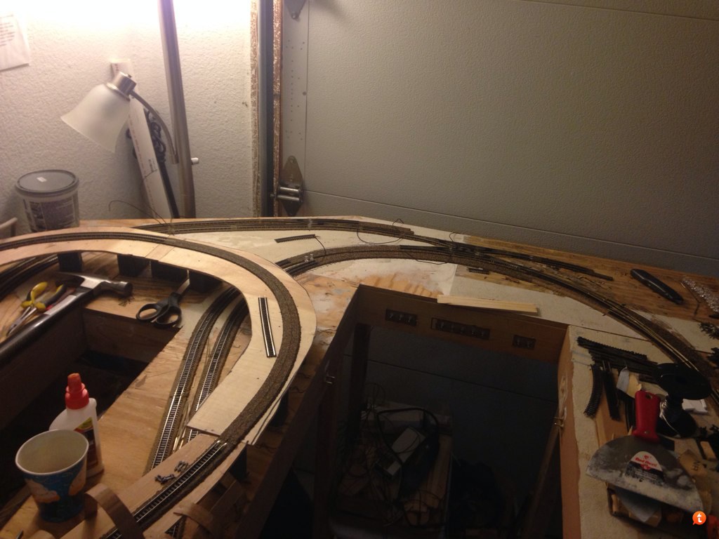

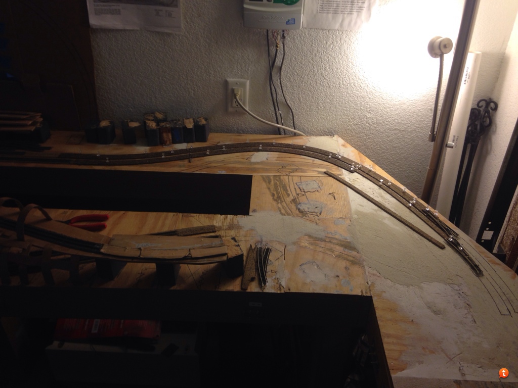

So here is the end I started remodeling. I didn't like the radius of the half circle in the mountains, and the sharp turn of the two twin tracks running under the mountains were both causing some derailments on longer cars such as intermodal cars and the long tank cars/reefer cars.
Here is what that end looked like before.....

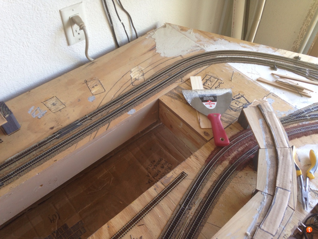

Elevated track and supports removed to remove the tracks underneath...
Here is one of the sharp turns that was causing trains to jump track...
Redone for a more gradual curve....
That's all for tonight, tomorrow I hope to get the rest of the roadbed down and start laying track. I've also got some curved turnouts on the way that should help this end out considerably.
Steve
Sent from my iPhone using Tapatalk

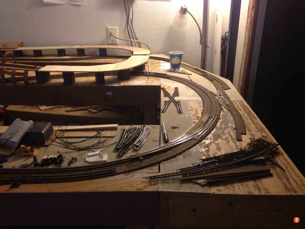

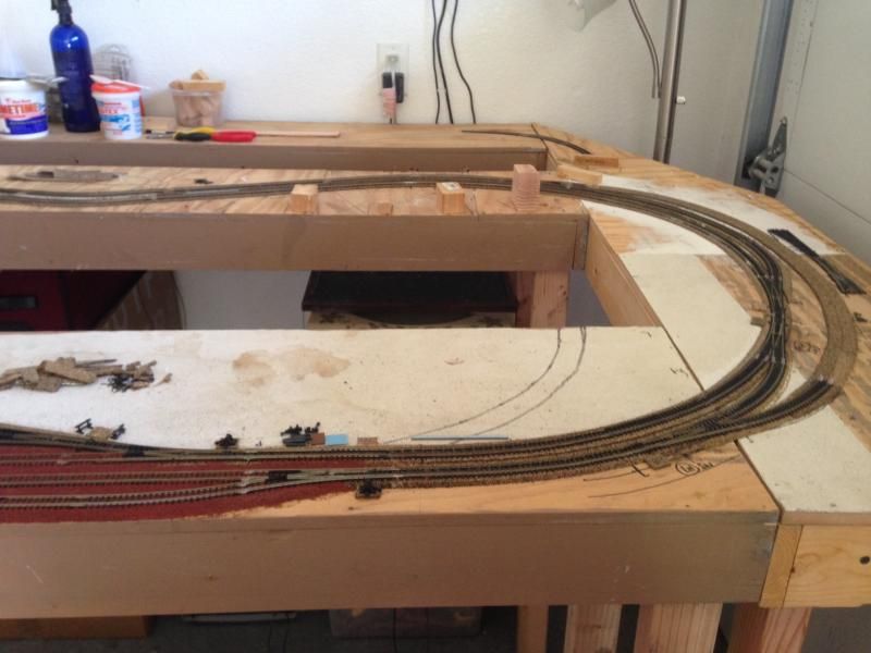

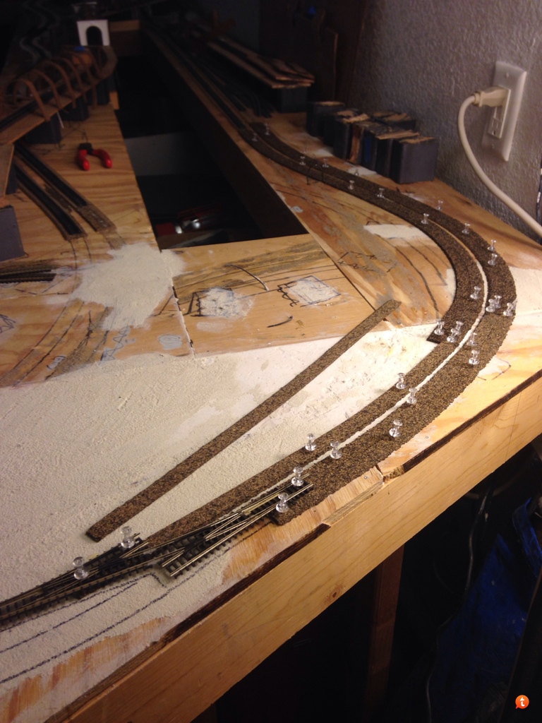

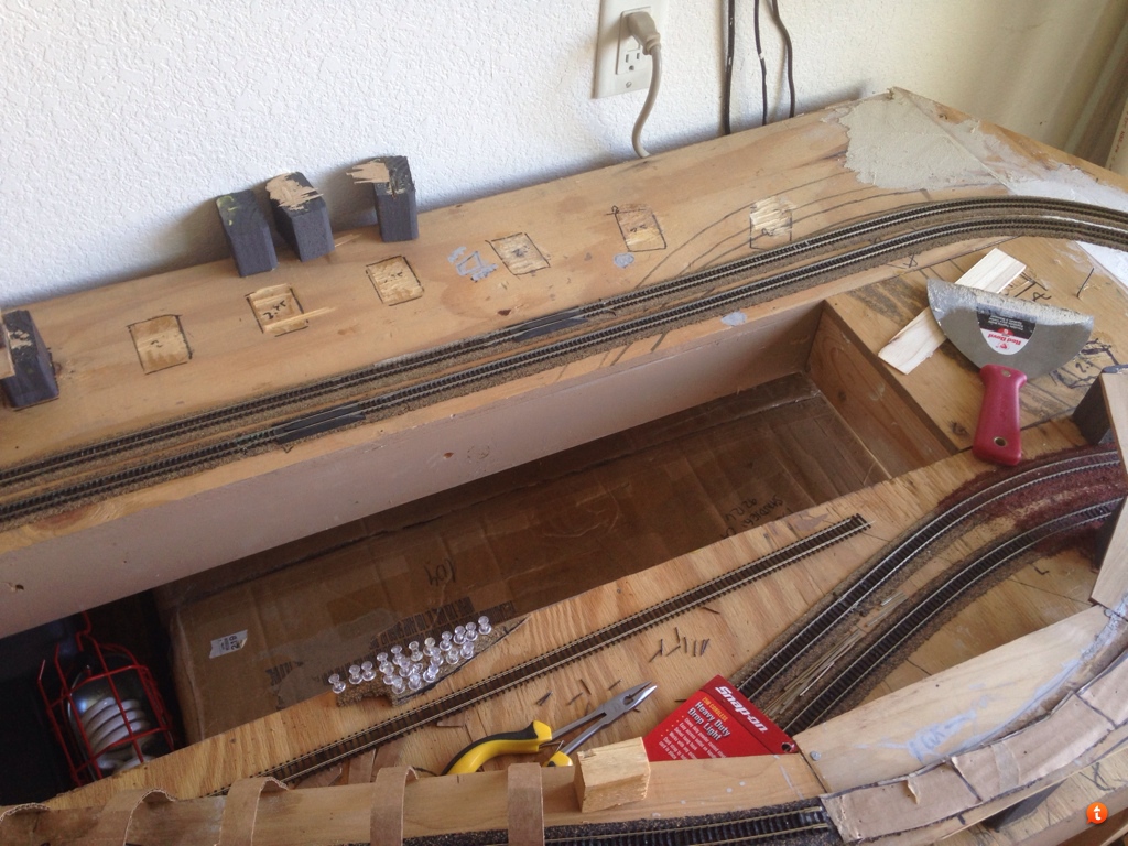

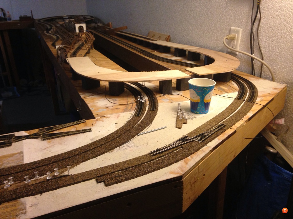

Got some work done this weekend but not as much as I had hoped.
Finished the new roadbed for the four tracks that go through the mountains....
Also planned out how I'm going to work the switches into the mainlines...
Put down the track for the four mainlines running through the mountains and reinstalled the new benchwork and supports for the modified dog bone for the track running up in the mountains...
The next few days I should be able to finish putting in the track and rewiring this end as I go, I've also got to lay the track on the elevated part of the mountains.
It's a lot of work but the better curves should work much better for the trains rather those two sharp curves I had before.
Thanks for looking!
Steve

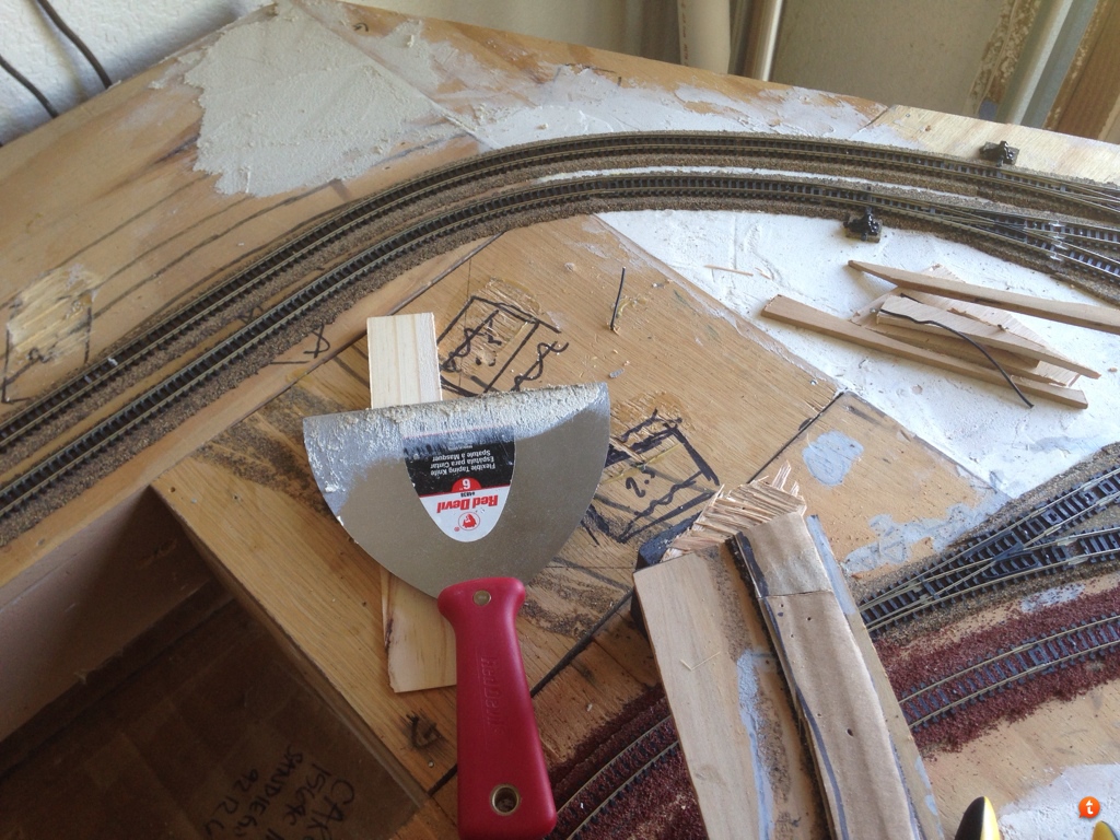

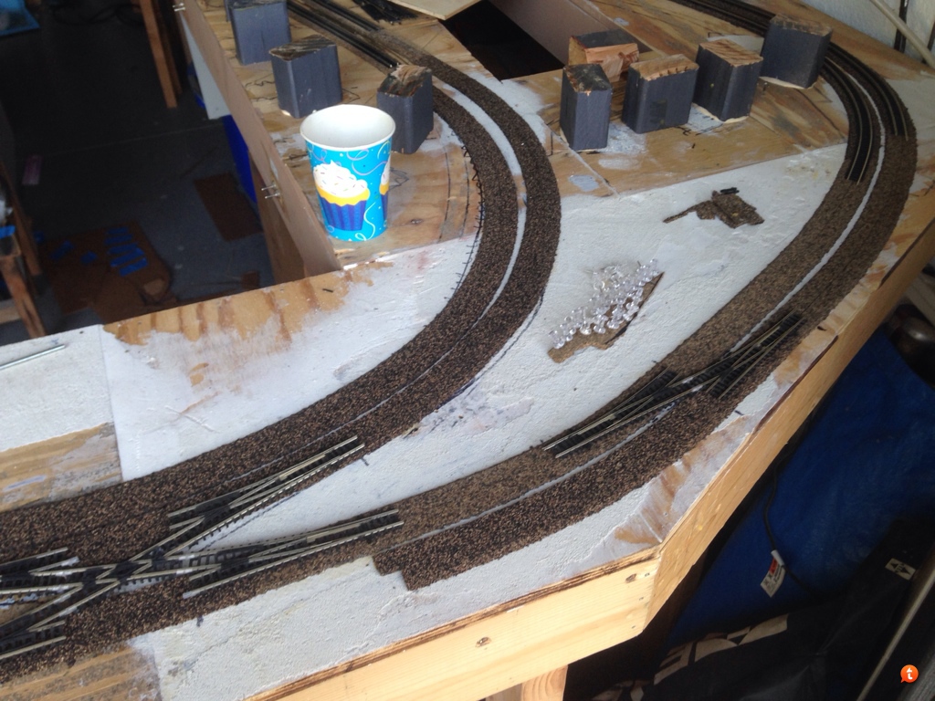

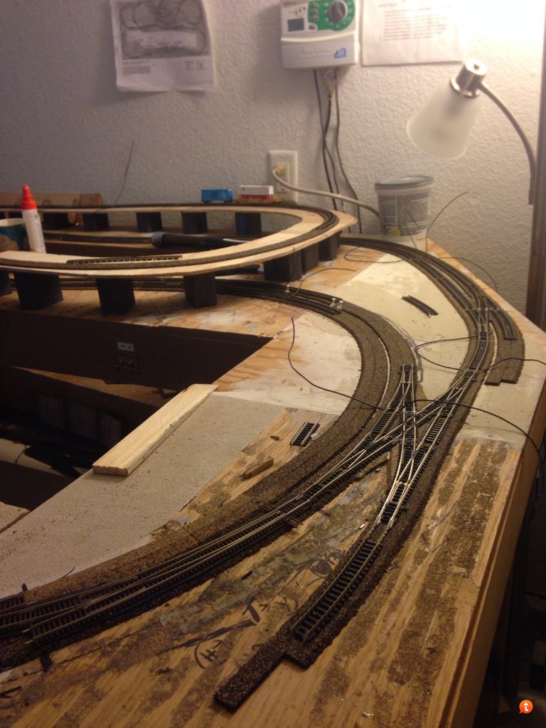

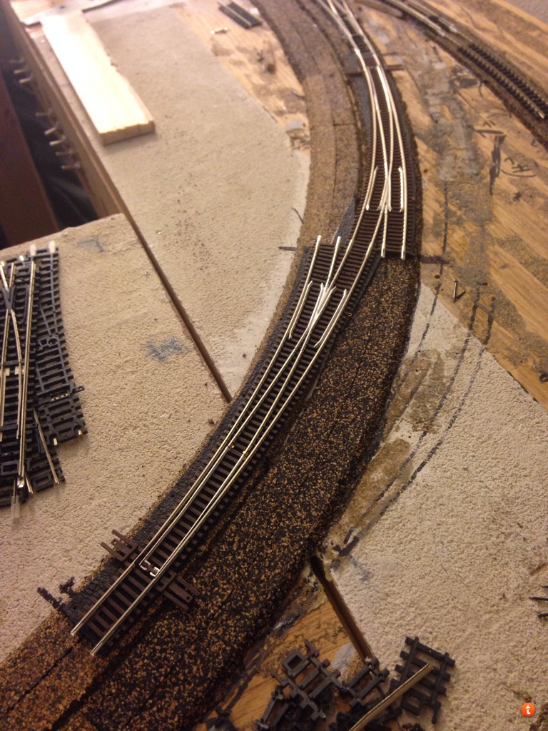

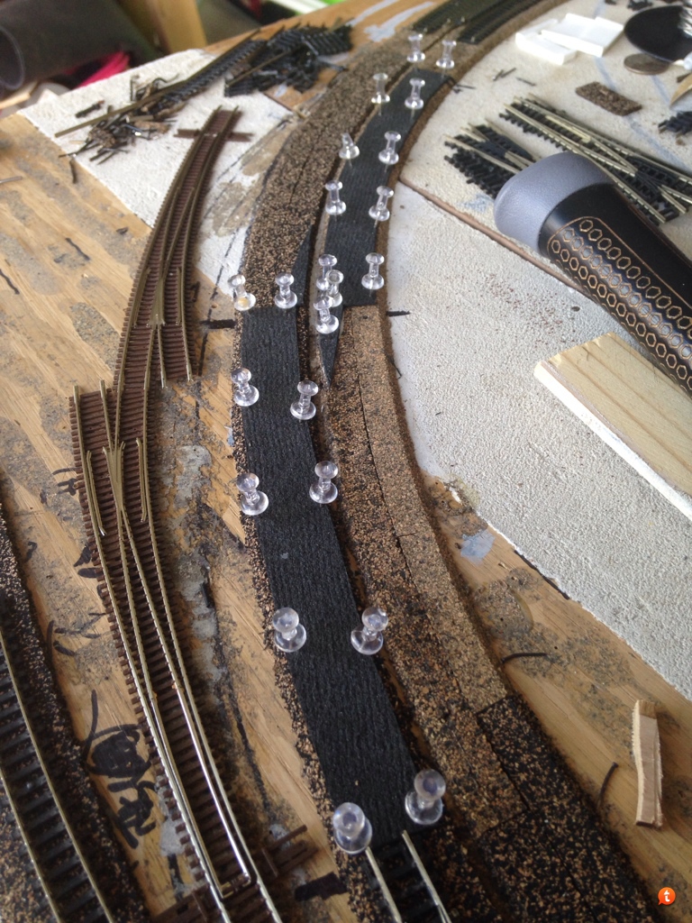

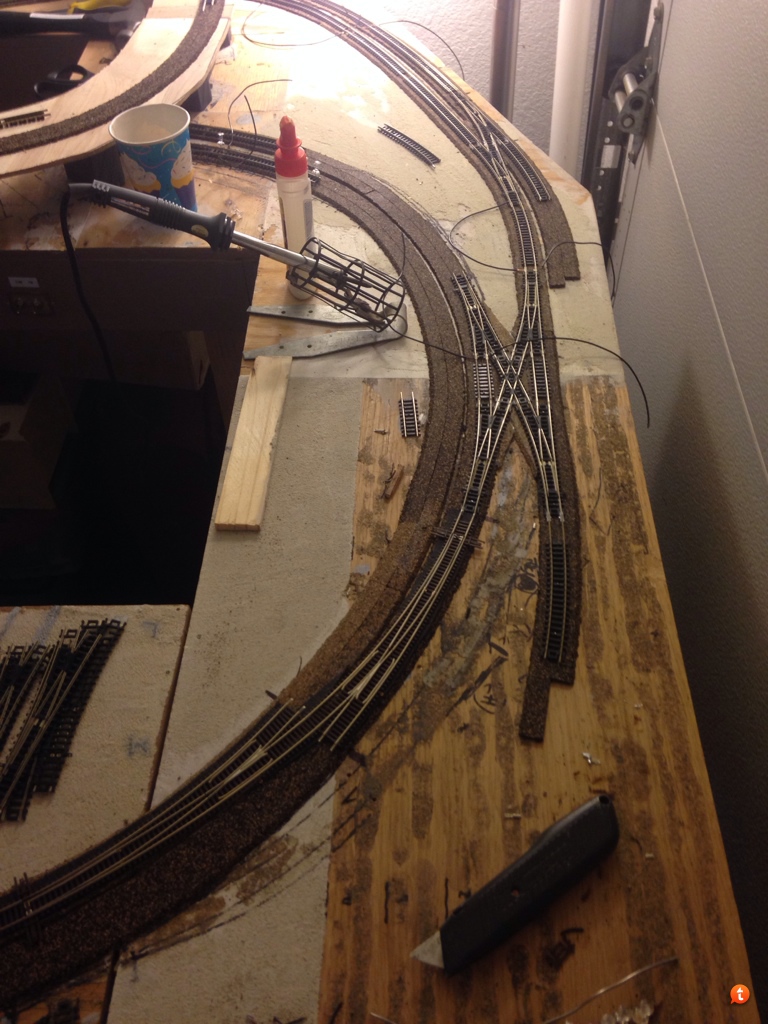

Started working the curved turnouts into the layout and joining some code 55 and 80 since only one has the curved turnouts. Thanks again "Nscaler" for posting the link on joining them. I personally added some material under the curved turnouts since they sit higher once soldered together.
Little bit of snap on tool box liners cut and glued above the cork keeps the two different track heights flush...
Curved turnouts soldered in...
Overview of the switches and interchange of the remodeled end. Just need to add in a few more sections of track and rewire the different blocks.
Sorry for the crummy iphone pics, lighting isn't too good in the garage at night. I'll take some in better lighting when I get this ends track finished.
Steve
